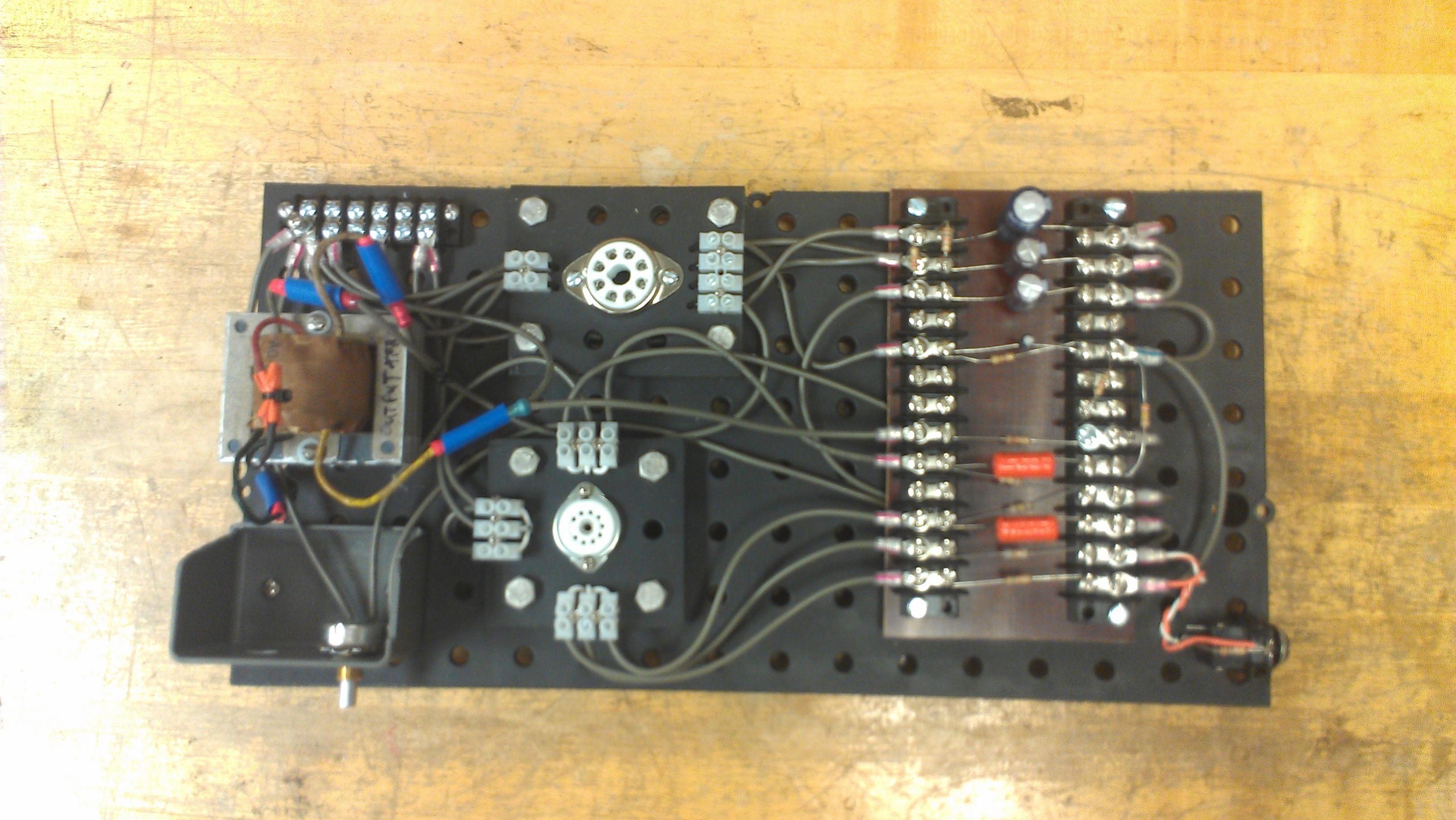

Currently waiting for new Champ PT and OT to arrive....Wanted to post a pic of my breadboarded 5F1. Could I have wire lacing/routing issues causing the squeal? Was using a p-p OT that used to drive two 6V6s, and B+ voltages were a bit off (both off an old Hammond S-6 organ). Will address those when I hook up the new xfmrs. Any comments appreciated. Thanks!

Well those long parallel runs are not the way it was done in the old days. You have to watch that inputs (signal grids) don't have long parallel runs to high current outputs. Putting the components right on the back of the socket looks messy,but makes for short runs. Heater wires were usually twisted pair in a Hammond organ, and return currents of input signals are run explicitly to the metal ring around the tube amplifying the signal, instead of using the generic chassis ground. Lots of cheap guitar amps used the mix-em-up in the chassis ground scheme, though. Hammond were coping with 25 mv tones coming in, I don't know what guitar pickup signals are voltage or current.
On your breadboard, I don't see any ceramic disk capacitors either. Hammond sprinkled those around to keep out oscillations from the grids by RF sources - like cell phones or switching power supplies of computers, TV's etc. There is much more RF around a home or bar these days than there was in 1960.
FIXED MY CHAMP SQUEAL PROBLEM!!
Just needed to shield the input signal from the jack to the 2nd stage grid (pin 7)...... learning the basics of amp building, not the hard way, but by finding what one can get away with, and what is imperitive..... Oh, and a known correct OT helped I think. Now I can start fiddling with voltages, tubes and components to learn how they affect gain and tone. Can't wait! Thanks for all your inputs too!
