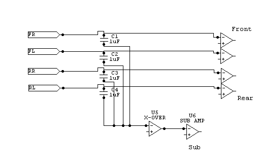

Not really. You'll be mixing the four channels not only to the crossover inputs, but to the regular amplifier inputs to. You need to connect, say, 10k resistors in series with the capacitors, and then connect theses to a virtual ground input. Look up "inverting summing amplifier" in a OP-amp cook book.
