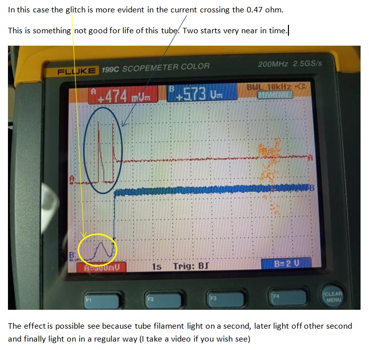

Hi Victor. I agree with you. I own TU8600 with Elrog tubes too. But only one thing. If ecc82 is not in good state, maybe that filaments of elrog tubes light off one or two seconds before light on again. I told to elekit to find how repair this problem, but they only told me use ecc82 in very good state. In picture is possible see two lines, in blue enable line of optocoupler and in red, current across filament: two starts every time..(filament light on, then light off two seconds and finally light on)
So, if you use elrog tubes be careful when ecc82 is not in very good state.
Best regards all.

Hi. I tried some types and for me, the very best is RCA clear top. But this, if is not in good state does a glitch in the enable line of optocoupler. And for ecc83, later try some, the best, for me, is e83cc of tesla. Elrog better than EML and Genalex.
But every person has different tastes...
The Tu8600 is an incredible amp. And with your upgrades and better tubes is really wonderful. Thanks a lot.
My problem with Elrog dissapear when change to another pair of ecc82 in good state.
