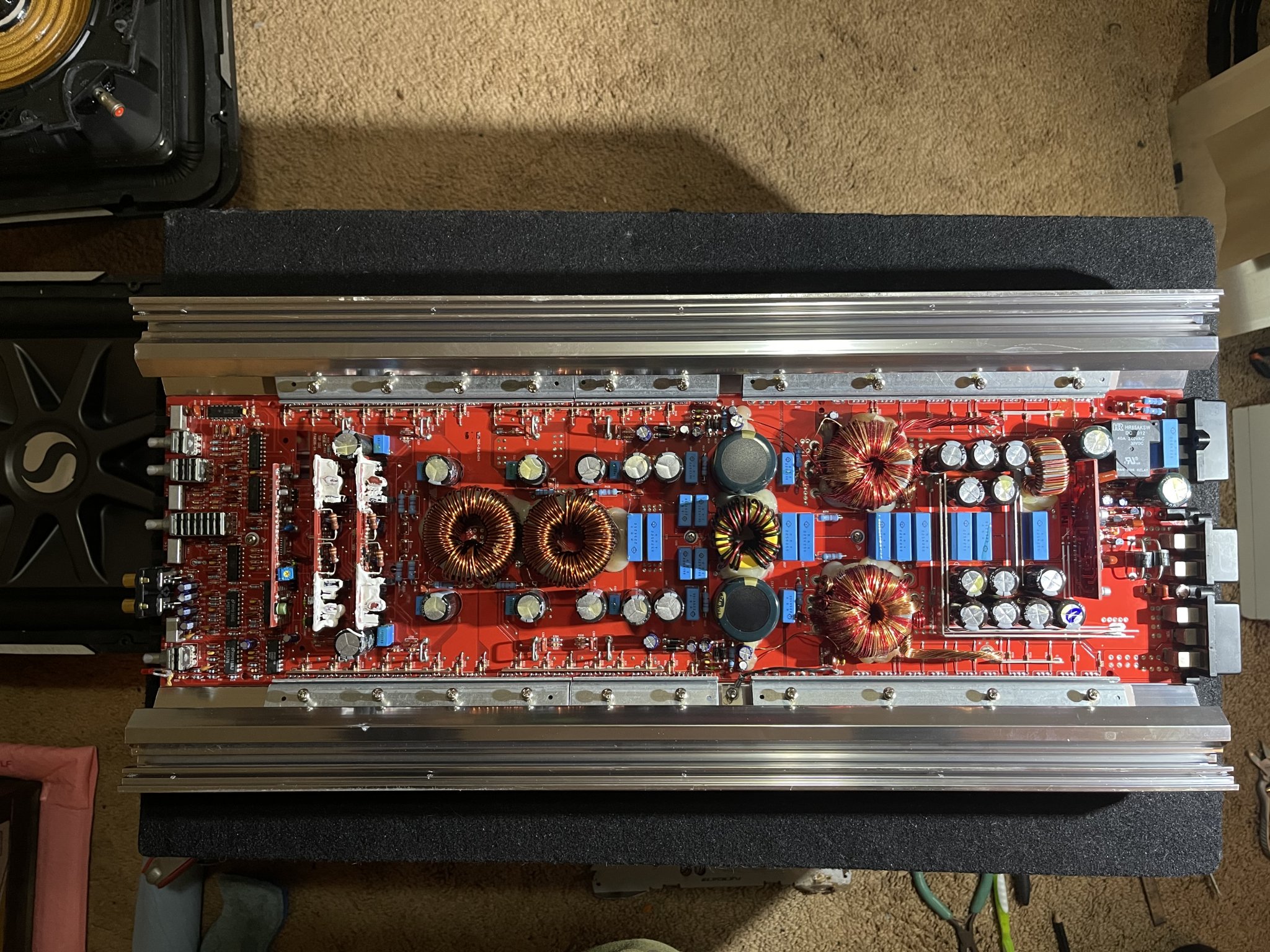

Hey all, so I just picked up an Orion 2500D, looks like it’s never been opened up, powered right up (spark when connecting +12v, assuming caps?) all seems to be working great except I’m getting a high pitched whine regardless of any settings, gain, filters, etc. Same pitch, was louder when first powered on but slowly lowered in volume to a point then stayed, did jump up a lil but while testing amp knobs/switches with music (I did put down some E6000 on components that didn’t have anything against vibrations (attached pic is beforehand) I read these are prone to that type of damage and I can see why after checking inside, I also went thru and cleaned knobs/switches, etc and got a few bugs out lol) I guess the amp sat for a year or 2 before I bought it? Everything works as it should, very happy with it, but that whine is annoying, what should I check to start with the troubleshooting process? This is going to be my main amp, it’s replacing an Alpine MRX-M110 and I plan on keeping it til death (Finally switching over to Orion after running Alpine for last 20 years, always had the itch and now it the time lol) maybe I’m spoiled with how clean Alpine is but I need to figure this out, I’m willing and ready to replace components that are not up to par/could be better/are known to suck/etc so any and all help greatly appreciated. I’m new to amp repair but dig it hardcore, I have a few degrees in PC Hardware and Networking, and am good with my hands, so def ready to dig in before I install it in my car. Thanks all, also anyone have a service manual for this? Trying to learn as much as I can, BCAE site is amazing btw 🖖🏼 Thanks and take care!

So after my first power cycle (shutdown and restart)I thought it went away but it came back, it’s not as pronounced as it first was but it is still there, cycled a few more times and it always starts as soon as the amp clicks (forgot what that process is when amp clicks at boot up, Class D switching starting up?) but ya, def need to tackle this, as I said earlier not opposed to replacing anything that even remotely needs it, I have a solder station, various fluxes and eutectic solders, small heat gun (not SMD rework type) DMM, cheap o $50 handheld oscilloscope, and a 12.75v 90amp server power supply I converted for home use. I’m in the process of ordering/waiting for delivery of more tools like an ECR? tester, SMD heat station, adjustable Low amperage DC power supply, etc. any other suggestions on what tools I will want for amp repair would be appreciated, I have a few I need to repair and plan on continuing to learn it all 🖖🏼 Thx!

Connect one channel of you scope to the power supply where you can see the switching waveform. Connect the other channel to the output stage where you can see the switching. Both need to be displayed at the same time. Does one waveform remain locked while the other waveform drifts?

Gzinc, thx for input bro, as far as the output on my amp it uses 5x irf9640 & 3x fb31n20d per bank, 2 banks per side for a total of 4. I’m assuming they are high and low side of output section? They all tested “good” from my diode setting check with DMM and amp does also work, I haven’t checked anything other then that cuz it does technically work. Are bad output fets that don’t kick on protect known to have this effect on monoblock class d amps? Might just dig a lil deeper, although I’m hoping once my proper Oscope gets in I can figure it out that way.
