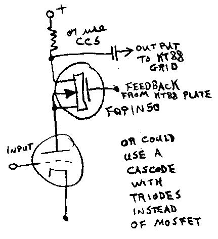

Hi Jan,
Any results on this design yet?
I was thinking recently about a local feedback scheme and thought it might be useful for your circuit as well.
By using a cascode gain stage instead of the EF86 stage, the input impedance of the "screen" can be much higher. This would eliminate any concern of phase shift due to the cross-coupled feedback going thru the output xfmr in class AB. (no current -> no phase shift thru xfmr leakage inductance)
A low capacitance Mosfet could be used as well for the top section of the cascode for simplicity.
A pair of CCS's could also be tried for the top section "plate" loads to put high gain in the local feedback loop. This would likely need some careful frequency rolloff network somewhere to maintain loop stability.
Don

No progress yet, I’m waiting for parts. The lead time for the OPTs is 4 weeks plus shipping and customs clearance.
The leakage between the primary sides of the OPT is not specified, but L Leak prim ref secondary is 4.4mH. The transformer is according to Sowter well suited for feedback circuits (no major resonance issues etc).
If we look at L leak (prim/prim) and the load (screen grid feedback) as a low pass filter, we know the load. The load is greater than 100k and if the bandwidth target for the feedback loop is 50kHz L leak must not exceed L=R/(2Pi f)=~300mH.
Before I have measured the prim/prim leak I can’t tell if I’ll need a Mosfet buffer or not.
Anyway, with three feedback loops, each of them could be kept relatively modest, and each of them will contribute to the amplifiers sonic signature in different ways. The ultra linear feedback is of course fixed but the other feedback loops are subjects for tweaking, and Mosfets could be a part of that.
Thanks for your interest Don. 🙂
