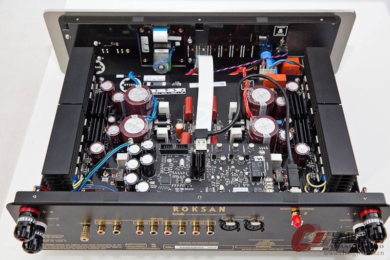

Here is the reason why I'm asking: I have Roksan Blak amp and Blak cd player.
I used to have considerable more expensive kit than this, but lost a little bit of interest in this hobby. It became more and more about components and chasing after better sound, and less about the acual music.
Well, with this Roksan kit it is the other way around. Everything I play just sounds so fun and full of life.
The tone is not bright, but it's like there is almost a resonanse peak at ssss sounds, driving me nuts. I build my own speakers, and I tried all sorts of stuff, 2nd order, 4th order, low crossover point, high crossover point, but it just will not go away.
But then I came across System7 here on this forum, and his 3rd BW crossovers. And that helped dramatacly. I then made some interconnects of Duelund cables, Duelund power cables and Duelund speaker cables, and then Duelund series resistor on the tweeter. All this helped a bit as well. I would say I'm 95% there.
Now my Blak cdp is on its way to Coris for mods, I have bought Biseki's output transformers and I am sure Coris will find some good tweaks as well. My hope is that this will give me those last 5%.
However, if that ssss sound is still there after those mods, I will turn to the amp.
By the look of it, my first attempt would be changing the coupling caps and ceramic resistors. I would prefer to not do anything drastic in there.

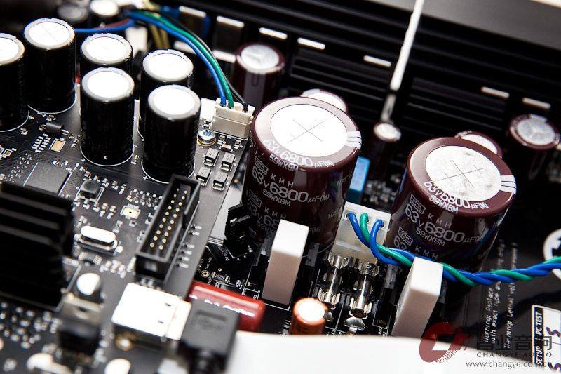

I see a 3-pin IEC power connector in this blak amplifier - are they using the PE connection for anything else than the installed mains filter?

PE is connected to chassis ground. This amp is very quiet, actually dead silent. With no signal I can turn the volume knob right up to max, and there is just a small hiss if I put my ear really close to the speaker.
I have tried several speakers, several sources, and compared it to a couple of other amps. The amp is actually a bit warmer than what I would call neutral, so this ssss sound stands out even more.
This amp has something to it that no other amp I have had, so I am not afraid to spend some time and a few bucks to try and sort this out.
