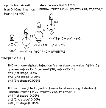

I tried a little sim on this, 3 stages with Aol=10 each (no poles), and injecting noise/distortion (a fraction of the squared input voltage, here) at one of this stages, in turn.
When the injection is made with the same levels at each stage, the reduction gets less the closer to the input I move (as expected), but with weighted injection (so that each stage has the same local THD which then gives the same THD at the output also) there is no change in resulting distortion. That means, if each stage adds the same amount of distortion with respect to its own output voltage it does not matter where this distortion takes place? Say, 10% THD in the IS, VAS or OS resp., one at time, doesn't change things?
Did I confuse things?

KSTR said:Hi,
- Klaus
I think it makes sense. With weighting down the THD depending on how close you are to the input, you decrease the distortion levels if they have more gain to go through towards the output, if I understand you correctly. I guess this weighting down is with the ratio of the OL gain of each block?
Jan Didden
Hi Jan,
Yes, the weighting is corresponding to the OLG of each stage.
But, then we have some (semantical) contradiction, somehow:
It seems one needs to qualify that "smaller". Smaller only in absolute amounts (say, injected PSU ripple etc). From the distortion perspective, the errors should be referred to the actual signal levels at each stage and then we have a "same in, same out" black-box situation which is "blind" to what actually happens inside...
- Klaus
- Klaus
No you didn't confuse things, you are quite right. I confused things.
In a LINEAR system, it does not make any difference where an error is injected, downstream of the subtractor, if the error % is the same. That's right, because everything is simply multiplied together.
