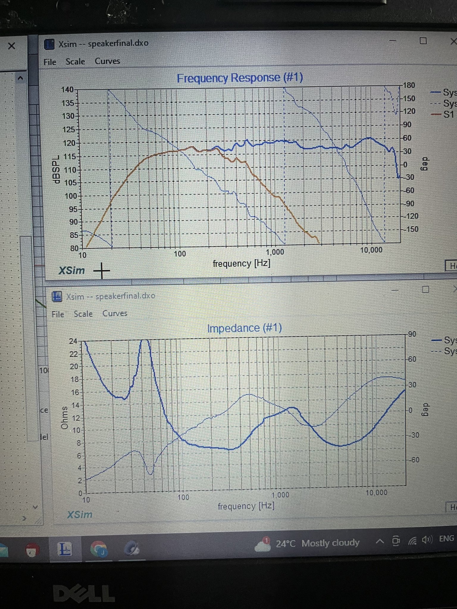

I’m designing a 3 way speaker, using all faitalpro 12fe300, M5N8-80, and hf100 with sth100 horn.
As this is my first diy, I’d like some opinions and to see if it’d work before I pull the trigger and buy all the parts.
I’ve ripped the frequency responses and impedance graphs off the faitalpro website. Using fpgraph tracer I made my own zma and frd files, and used xsim’s predicted phase.
The 5” m5n8 will have a small box around it made of the same 18mm mdf that the rest of the box will be made out of. Port is 30cm by 5cm by 3.9cm deep tuned to 50hz In a roughly 220L box.
Pictures attached are frequency response on xsim , impedance, and dimensions.
I’ll be attaching a 4ohm resistor before the amp when plugging into an 8-16ohm300w amp before I get a 2-8ohm tpa3255amp(where I will stop using the 4ohm resistor, I’ll get a high wattage resistor). Will I blow anything up? Lol

The 390uF cap will probably mess up your bass response if you use a ported enclosure.
The manufacturer's response and impedance graphs are usually measured in an infinite baffle.
Also, did you consider baffle step and other diffraction effects?

I thought adding the capacitor would protect my woofers from over extending at high wattage but I’m not sure if I just need to eq it or not, (as it goes over xmax below 50hz at 300w on winISD). I was using it was a ~50hz hpf.
I haven’t considered baffle step. I also have an equaliser I could plug in before the amp, could placing it in the corner of a room mean mean no need for BSC?

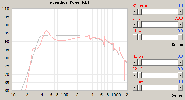

I made a quick simulation with hornresp, just to be sure I am not writing BS.
here is what the cap will do (red) to your woofer's response (grey):
that is a terrible idea - it will again mess up your response and it will get VERY hot!
furthermore you do not need to do that. as far as i see the impedance just goes down to 6 ohms which IMO is within the tolerance for an 8 ohm speaker.

400 - 2k needs to come down 3 dB which is basically your total midrange output. Otherwise it will be very fatiguing to listen with most music. The 10k treble bump needs to at least be dropped 2dB if it needs to sound palatable and accurate in an acoustically live and hot room.
The bass will be disappointing with that big C7 cap in there.
