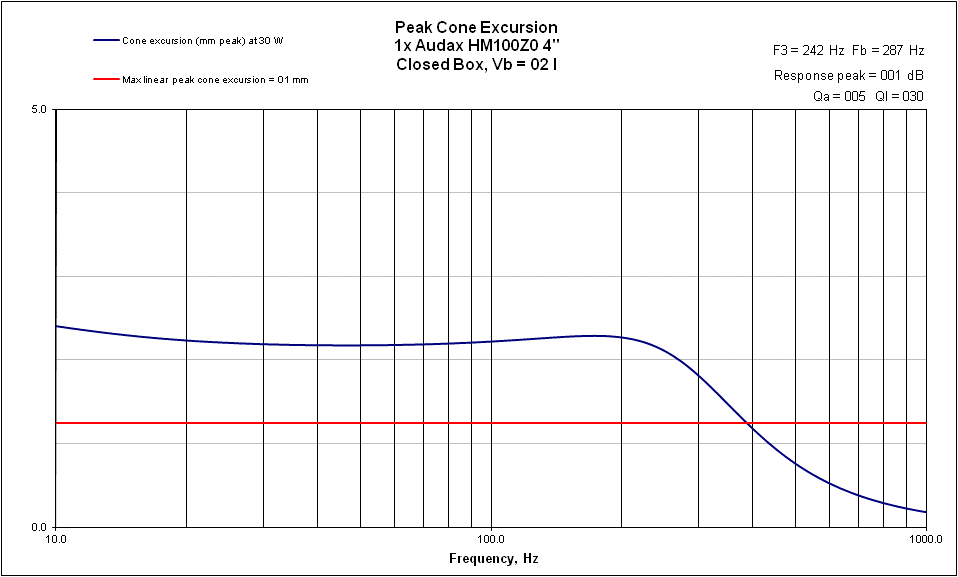

Applying these to your choices, let's start with the Audax. Clearly, you want to keep distortion to a minimum, so you don't want to exceed xmax. First graph below shows the FR of the Audax in 2L with 30W. SPL at 1 m is 107.7dB. Left of the red line shows the frequencies at which xmax is exceeded. The limit here is the point at which the lines intersect, about 400Hz. Using a steep xo (3rd or 4th order) at 500Hz should hopefully diminish output below that point enough so that xmax is not exceeded. Second graph shows the same thing, peak excursion, in a different way - below the red line=good; above=bad. Again, point of intersection is about 400Hz.
So, this effectively limits your speaker to a max SPL of about 107dB at 1 m. Maybe 105 to be more on the safe side. Happily 30W is also below the Audax's max power of 40W. Of course if you move the xo up to say, 600Hz, that should allow a little bit more SPL. But if you also want to keep the xo at the baffle step point (not necessary, but helpful), now the baffle needs to be a little narrower- closer to 7.5" for 600Hz instead of 9" for 500Hz. And that makes a difference to your woofer selection.

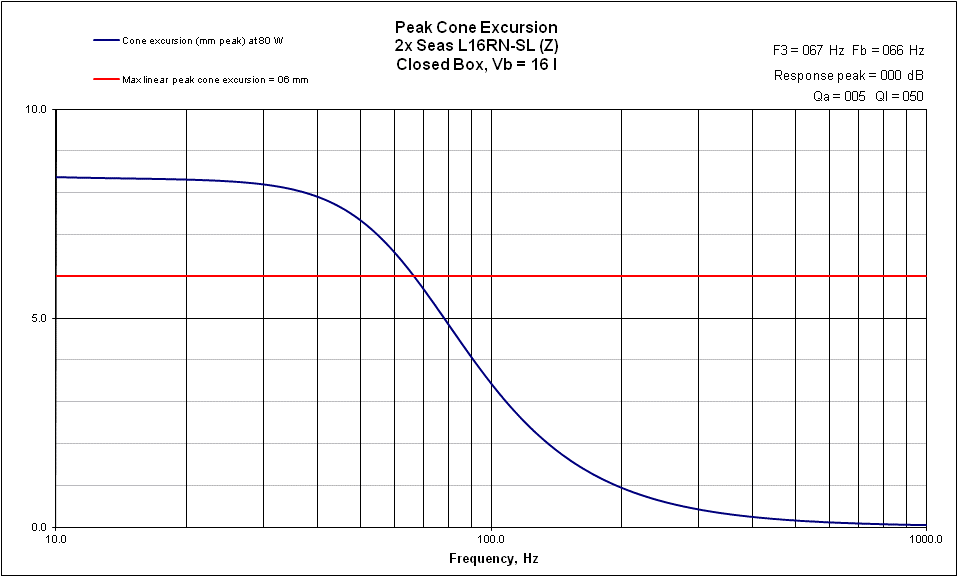

Next graph is the cone excursion of 2 Seas in 16L, sealed with 76W and SPL of 106dB (1 m). xmax is exceeded at about 66Hz but it will be crossed at 80Hz so this is probably about your max SPL here with these. X mechanical though has an additional 5mm each way.
The 4th graph is 2 Discoveries in 24L, sealed with 38W and SPL of 106dB. Again, xmax is exceeded at about 66Hz. X mechanical has an extra 4mm.
So, the Seas and Discoveries look about the same in terms of max SPL. It's how you use your mid however that's going to limit how loud your speakers will go. But it's your woofer choice that's going to determine how much power your amps are going to need to get you there. And if you want some amp headroom for the peaks at this level then the advantage goes to the Discoveries. A 150W amp will have 3dB headroom with the Seas and 6dB of headroom with the Discoveries. The Scans will need a larger box though and the 9" wide baffle.
