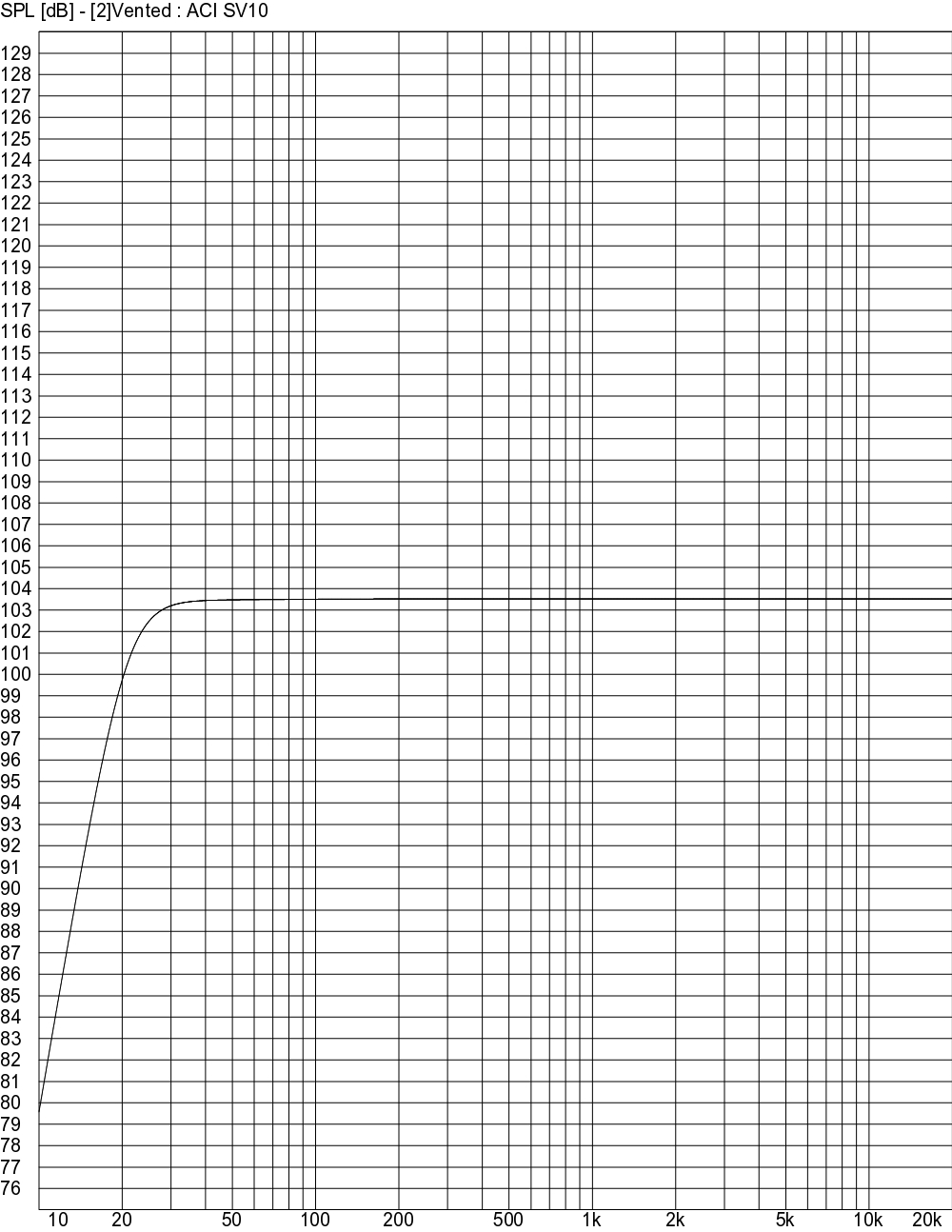

It seems to be working okay.
It seems to follow the same predictions as Winlsd on my latest subwoofer box using 3 X 8" PRO-CSW800 Radio Shack subwoofers in a 3 cu.ft. box tuned to 26hz.
The ports seem to be the correct length at about 2 X 4"dia X 33"L.
I am using Chrome ver14 right now and it is the Bomb compared to IE8.
I would like to see a group delay chart and maybe a spl output chart.
I like the idea of seeing all of the charts at the same time when I make a change of a parameter,Winlsd does not do this.
Great job and keep up the good work!
I will play with it some more and let you know when I come up with some more idea's for you to implement.
jer :)
The Spl out when driven by the signal.
Maybe ireleavent, But Winlsd does this and is good to show when comparing number of drivers to excursions.
Where as the transfer curve is the frequency response and spl would show the theoretical output curve as per power in.
Although this can easily be calculated in the head but seeing the graph with the numbers some times gives you a different perspective on what you should expect to hear and/or experience.
jer :)
like this example.
Had I changed the scaling the curves would look a little different.
I just did this quick and then I had to find a .xps to .jpg converter,What a pain!
But maybe you will get what I am saying.
Either way I like your program alot.
jer :)
