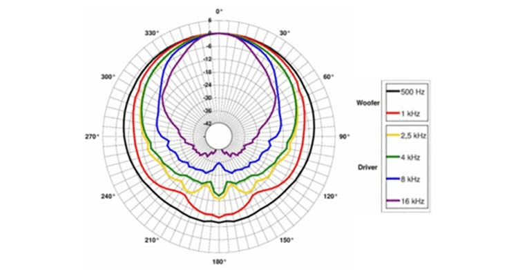

First, the frequency response charts and polar plots we typically see on "spec sheets" are almost always "smoothed", Whether 1/3 octave, 1/12 octave, or whatever, and whether it's loudspeakers or microphones, we're typically not seeing the nitty-gritty soft white underbelly of the unit's performance. There are often wild swings which don't show up on these charts. In particular, off-axis response can be pretty nasty. This is one reason why there are inexpensive ones, and very expensive ones. Second, high quality condenser microphones will typically have smoother actual response curves than dynamic microphones, but they tend to be less rugged and more expensive than dynamic microphones.
