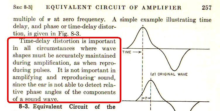

Tests have shown our ears distort a considerable amount but our ears are very sensitive to phase shifts.
Fred Terman does not agree,

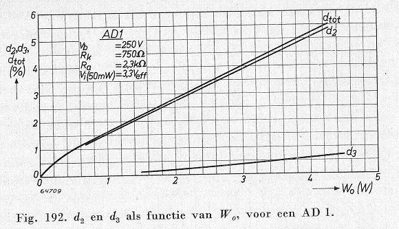

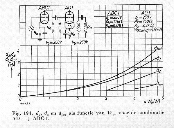

To illustrate the effect that the distortion of a preamplifier tube can have on the distortion of the combination "preamplifier tube + power triode":
The first diagram shows power output against distortion of an AD1 driven with a undistorted input signal. The power output is 4.2 Watt at 5.5 % total distortion.
The second diagram shows power output against distortion of the combination ABC1 + AD1. The power output now is 4.8 Watt at 4 % total distortion.
Note that the total distortion in the first diagram is for the largest part made up of second harmonic distortion, while the distortion in the second diagram contains a much bigger part of third (and fourth) harmonic distortion.
I'll take the second over the first, any day. It's the first watt that is important.
Modelling shows that with cathode feedback the 2nd can be larger than the 3rd. Only at the "perfect" load goes the 2nd below the 3rd. And how many speakers present a "perfect load? Not to forget that most distortion in the OPT is 2nd.
Phase shift: Read the article many years ago, never saved it and am not going to look for it now. Some people are sensitive to it, others not, YMMV.
In older literature you often read that the human hearing doesn't detect phase shift/distortion. What surpises me again and again is that this statement often is not backed up with proof/literature.
Attached a more recent master thesis on the influence of phase distortion on sound quality that I found on my PC (conclusions on pages 59 to 61).
What frequency did you make the measurements at? What was the load? Is it the same across the entire audio bandwidth?

They are not mine. The diagrams are on pages 267 and 268 of Book V from this Philips series on tubes. The book is in Dutch though.
PHILIPS' TECHNICAL LIBRARY - Series on ELECTRONIC TUBES
The book doesn't clearly specify at what frequency or frequencies the measurements were made, but on pages 262 to 266 there is a description of an installation to measure power output and distortion, which uses an oscillator and filter for 500 Hz.
The book explains that the ABC1 has to deliver 35 Veff to drive the AD1 to full power. This creates relative high second harmonic distortion in the ABC1, which cancels in part the second harmonic distortion of the AD1.
