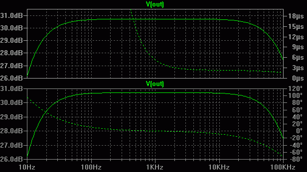

Just an illustration of delay, and phase.
Dotted line in top graph is group-delay, and dotted line in bottom chart is phase.
(Spice-simulation of a 3-stage SE amp - with no feedback)
Yes. there will be a little delay, depending on frequency.
The feedback, while reducing overall distortion, usually affect the composition of harmonics - more higher order harmonics.
Then there is IM distortion, and TIM, and whatever else.
Reducing the need for feedback, or the negative effects thereof, is indeed a way to achieve good sound 🙂
Svein
I didnt want to say delay in the feedback , i wanted to say delay in path of the signal from the input to the output (the signal takes some time from the rca jack untill the speaker) even at the speed of light ,it takes some time i think.Maybe like the slew rate of an ampop,the bigger the slew rate,the fastest is the ampop,less time the signal takes to reach the output. But maybe i am wrong , and thats why i wanted to know what you guys think about that.....All of you who keep referring to and insisting on the exsistance of a ''delay'' in the feedback, still don't get it. There is no delay. The phase shift of any particular frequency at the OPT is just an attenuation of the feedback level of that frequency. The feedback line can be tailored with components to equalize the levels and compensate for frequencies that can cause oscillation in an unstable amp. But that has nothing to do with the fact that there is no delay in the feedback signal returned to the input. That's why a square wave is used to see any inefficiency. You have to use a quick rise time wave just to see anything.
Let me try again:
Usually, the OPT has the highest contribution to phase shift (that I regard as form of "frequency dependant" delay) than any other component in a tubed amplifier.
(Sure, one may make this statement false in not using decent coupling or bypass caps values)
And that is true at both low and high frequencies.
This, when included in a FB loop may cause (for exemple) botor boating as well that a larger (but sometimes lower) distortion spectrum.
Yves.
