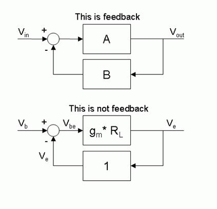

At any rate, there are those that claim that an emitter follower has "100% negative feedback". Please allow me to explain why I disagree with this terminology.
In the first place, the term "feedback" clearly implies that the signal is being "fed" "bacK" from a later point in the circuit to an earlier point in the circuit. In all circuits that use feedback, except the emitter follower, this is true. In the emitter follower, the emitter is simultaneously both an input port and and output port. So the signal is *not* being "fed" "back" from a later point to an earlier point.
Well, while the emitter is at the same node as the output, it's not actually the output. The output is the voltage across the emitter resistor as a consequence of the current flowing through it.
Look at the transistor's equivalent circuit (as a transconductance device) rather than its basic schematic symbol and I think it becomes more clear why the emitter isn't the output.
In the equivalent circuit, you have a current source whose current is controlled by the base/emitter voltage in the form of gmVbe.

The second reason is that if we look at the case of a common emitter amplifier with an unbypassed emitter resistor, we will see that there is an action in the circuit identical to what happens in an emitter follower. If one were to call this action "feedback" you would run into a difficult semantic problem.
No you wouldn't. It might be problematic for the marketing department. But that's about it.
Specifically, take the case of a common emitter amplifier with *no* emitter resistor. Due to the Re of the transistor itself, the gain is limited. So if one were to claim that there is feedback with an unbypassed emitter resistor, to be consistent one would still claim there is feedback even with no emitter resistor whatsoever.
Yes, they would claim that there is feedback. Because there would be feedback. There is no semantic problem because however much or little feedback there is, that doesn't change the definition of feedback.

To explore the third reason, we must look at why people want to avoid feedback in the first place. In general, people are trying to minimize or avoid the use of feedback because they have found that there is a detrimental effect on sound quality. We don't know all the reasons why this would be true, but for the sake of argument let's assume that it is because feedback can't correct an error until after it has occurred. This is because there is obviously a time delay involved in a feedback loop. The circuit cannot respond instantaneously (if it did it would have infinite bandwidth) and so there is a time delay between the input and the output. So the feedback loop is always responding after the fact. But in an emitter follower, there is no time delay. This is because the emitter terminal is *both* the output port and one of the input ports.
The key phrase being "one of the input ports."
But the current, which is what flows through the emitter resistor to give us the output voltage, is controlled by the voltage BETWEEN the base and emitter. And since the input signal exists between the base and ground, how can there NOT be a time delay?
So the bottom line is that to call an emitter follower a feedback circuit is not useful in any way, in my opinion.
