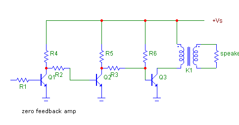

A zero-feedback amplifier is capable of inaudible levels of distortion at high listening levels, but in this specific instance it did not because the amplifiers were clipping when played back at high levels with those speakers in that room.
I agree with the statement: “A zero-feedback amplifier is capable of inaudible levels of distortion at high listening levels”
Which amplifying stages are zero-feedback stages?
a) Triode stage (common cathode), working on low impedance load (RL<Ri), with cathode resistor shunted by bypassing capacitor (or without cathode resistor at all).
b) Triode cascode stage (common cathode-common grid) under the same conditions
c) Triode-based long-tailed pair under the same conditions
d) Pentode stage (common cathode), working on any load, with cathode resistor shunted by bypassing capacitor (or without cathode resistor at all) and without feedback to the second grid.
I’m sure that one can design amplifier with inaudible levels of distortion using these stages

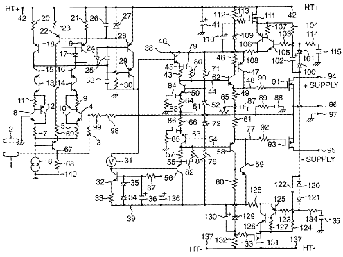

dimitri said:
Dear Hugh,
http://users.otenet.gr/~athsam/electrocompaniet.htm
This is classical Otala amp from IEEE transactions, dated back to 1973. Here is the full story:
http://home.online.no/~tsandstr/
Another copy of the Otala/Lohstroh amplifier appeared in the Netherlands a couple of years later. It was the JK acoustics Mono Block Active 1 from Johan Ketelaar. See http://www.jkacoustics.nl/ClassicsActiveIMk1.htm This also was a famous amplifier. In the early eighties I borrowed one from a local HiFi shop and took it completely apart in the weekend to look at what was inside. It appeared to be a copy of the Otala/Lohstroh amplifier, although with other transistors (input differential with 2SC1775A, second differential with BD237, differential VAS stage with BD237 and BD238, drivers with 2SD718 and 2SB688 and output stage with 3 times 2SC2565 in parallel and 3 times 2SA1095 in parallel). I still have the complete hand drawn copies of the PCB layout and the schematics derived from the layout. I must have thought, now that I have a chance to look inside, better do it good. Anyway, I never did anything with it. When I recognized the design, for me the fun was over. 😉
Steven
