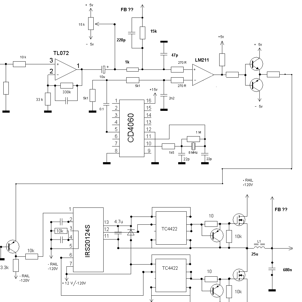

I am trying to modify an existing schematic (the PCB is already printed). This means I cannot modify too many things, except changing a few parts. I would appreciate some help in finding the best feedback configuration for this schematic.
As I said, no large modifications are possible (like replacing IC's),
Please drow on this schematic
Here it is!

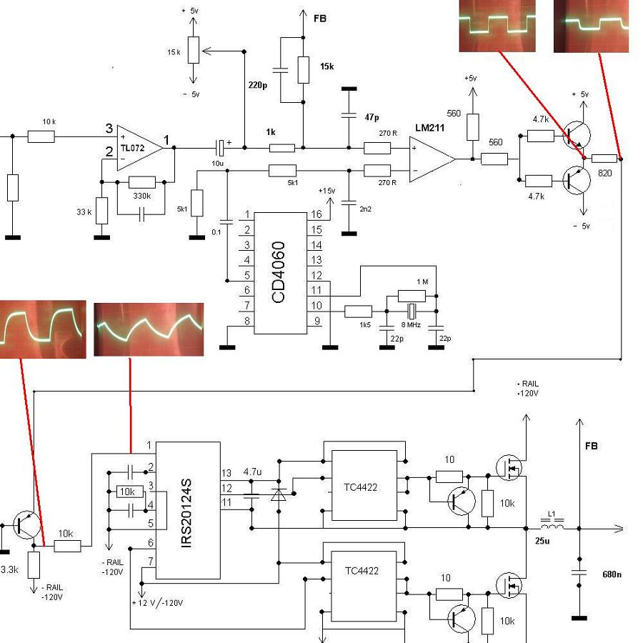

This is a nice way to describe the working of your circuit!
Your scope probe seems to have too much capacitance, you should have to change to 1:10 type, but othervise the 10k at the input of gate-driver is too high also. It's better to have much smaller impedances where you need fast changes. You could also increase the current of level-shifter.
Otherwise does it work more or less well?
I've just recognized: +/-120V ?!?
