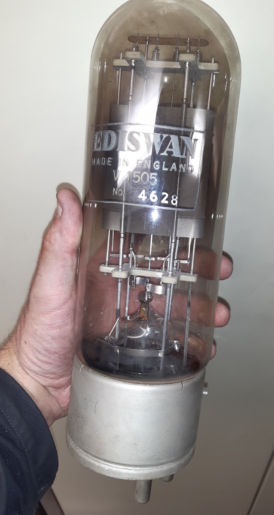

Federal Telegraph F-123-A 125W triode
Any hopes for these bottles? Looking at the limited datasheet it looks like high mu types designed for positive grid drive. ?
I got these when helping cleaning out somebody's closet so to speak.
I think these require 1500V or more to sing well, so I doubt I will ever build with them. Perhaps make a pedestal and just have the filament glowing and have a neat light on the shelf...
The other pic is the big philips transmitter tubes I also got, and same problem with them. An 813 is on the right for size.

Thanks for replies. Well I am feeling encouraged. 1100-1200V is nothing. My mental barrier is about that. Perhaps I need to look into the classic WE designs, or AN, or even Thorardson. It will be interstage/driver transformers all the way if I do build with these.
Big $ for quality interstage trafos. 🙁 A cost effective alternative is DC coupling MOSFET source followers to the O/P tubes' grids. Also, other than (possibly) the O/P "iron", transformers inside a NFB loop is asking for trouble. Damping factor and/or linearity considerations may make loop NFB of some kind desirable.
