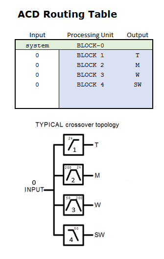

I came up with another feature for the next version of ACD: a routing table. A routing table describes how inputs and outputs should be connected.
Currently the routing is assumed to follow this topology:

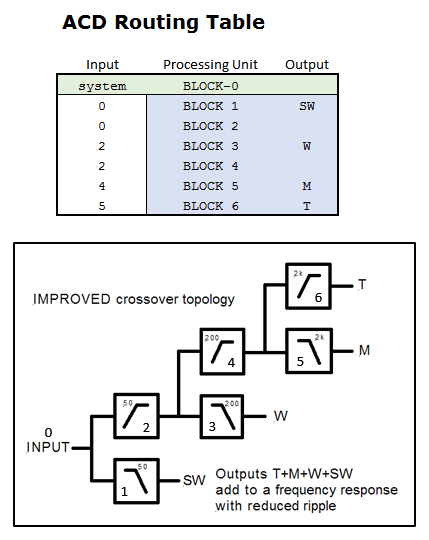

A "staggered" topology can also be used in which:
Woofer crossover & offset
If I add a couple extra slots in the system spreadsheet for more processing blocks instead of just one per driver like I do now, the branching scheme could be modeled, and signal routing implemented with the routing table as shown in the attachment.
In the past when I was considering the miniDSP products only the "parallel" scheme was needed because that's all that the miniDSP can implement. But now that I am planning on implementing LADSPA plugins for Linux based audio, a "branching" scheme is finally possible. As a result it only makes sense to make it possible to model this in the Active Crossover Designer as well.
Feel free to share your thoughts on this. I will add it to the "to do" list and think about how to best implement it a little more.
the signal is supplied to the system and the system filters are applied
the input for driver 1 is the output of the system filters
the input for driver 2 is the output of the system filters
the input for driver 3 is the output of the system filters
the input for driver 4 is the output of the system filters
You can think of this as a "parallel" routing scheme. This is built into some DSP hardware like the miniDSP. I give an example of this in the attachments.the input for driver 1 is the output of the system filters
the input for driver 2 is the output of driver 1
the input for driver 3 is the output of driver 1
the input for driver 4 is the output of driver 3
etc.
This is a branching scheme, and for some types of filters it is superior to the parallel scheme because the phase alignment is better in each channel. SL presents some info on this here:the input for driver 1 is the output of the system filters
etc.
