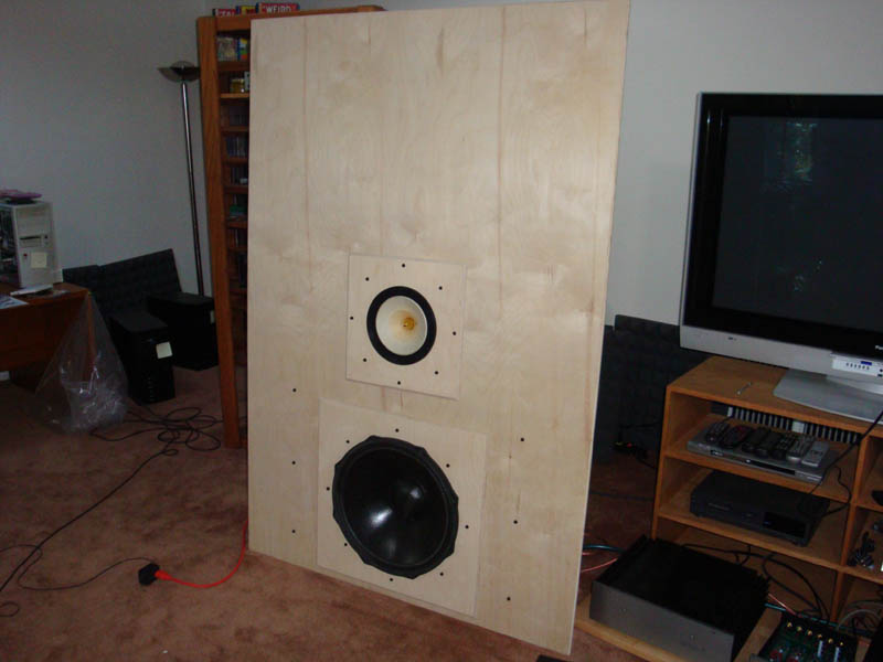

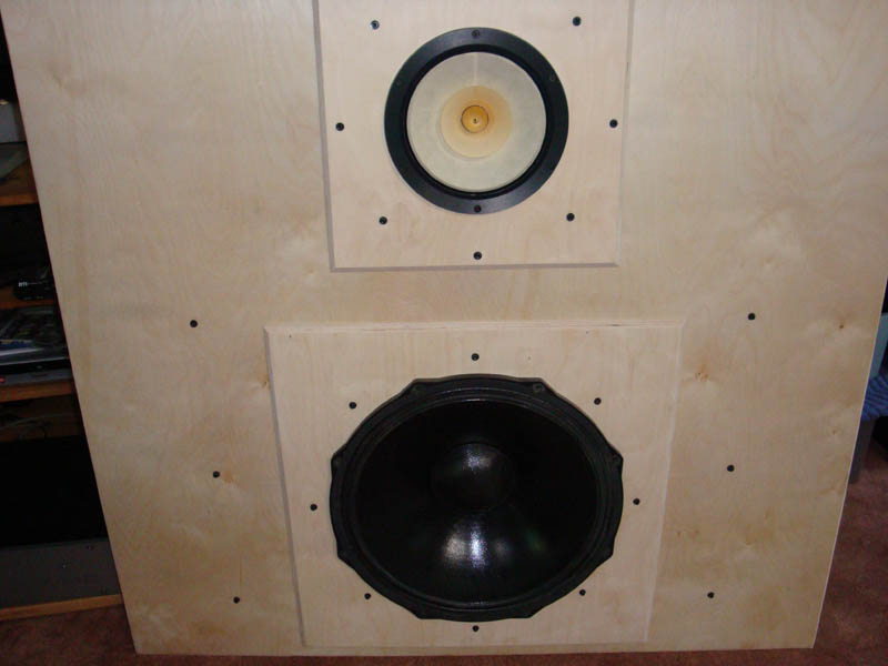

Ah. Here we go.
The D9nf is mounted in a flat 4 foot wide by 6 foot high open baffle,
sharing the space with a PHL 18 inch woofer.
Not the biggest speaker I have ever had, but certainly the 2nd
biggest.
I set the baffle up with replaceable driver panels so that I can swap
different drivers for both the full-range and bass.
The response of the Feastrex was dramatically improved over the
previous baffle, which was 2' X 4'. The bottom end of the D9nf
starts to drop off at about 60 Hz instead of 200 Hz.
The crossover was much easier to implement as well: 12 dB/octave
at 40 Hz for both drivers is the first (tentative) setting. In the long
run this is probably too low, as it is easier to overdrive the D9nF.
The larger baffle improved the midrange performance as well - the
5 KHz peak that required equalization in the smaller baffle is now
run flat with much less complaint.
Here are some pics:

Nelson,
Nice big baffle. Lifts many problems of smaller ones. You could use smoother edges on your Feastrex add on panel, better for diffraction. Although such a driver is beaming enough, surely there is some bouncing there. You can decide if there is any audible consideration by framing the add on panel with some foam strip layers. Quick and dirty but tell tale.
