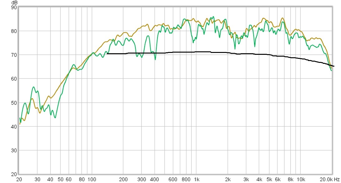

More measurements with some confusion.

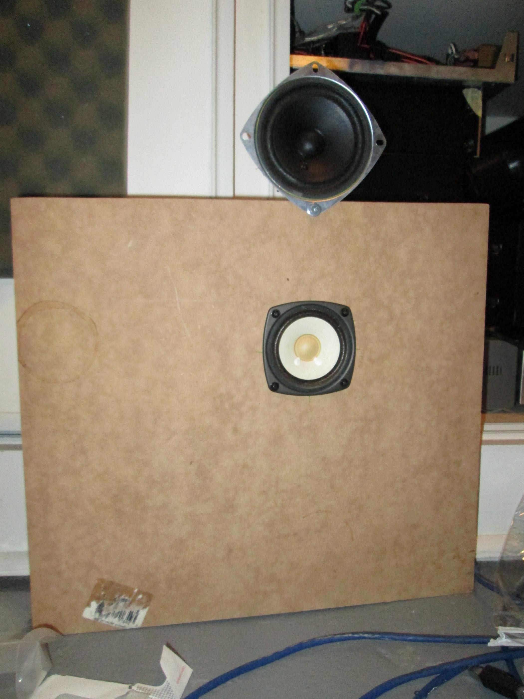

My seconded OB, 35" high by 24" wide, ~1/4 thick foam core, with 35 by 12 "wings" at 15 degrees from parallel to main baffle. Blue at 6 inches, and Red at 24 inches.
NB. this baffle has the damaged dust cap.
Interesting enough, with off cuts I was able to make a sealed box with ~16L volume with the following measurements. Yellow at 6 inches, Green at 24 inches.
NB. undamaged driver.
I am confused though, for one thing there seems to be a roughly similar slope at the 10K+ and 20 - 200hz with a completely different enclosure. 400 hz is ugly in both cases. 2.2khz is just ugly in the OB.
I am right to be confused?

1. Looking at the last graph you posted, this speaker is going to sound shouty. A positive spin on this sound can be called detailed, revealing, ruthless. However, a quick comparison with a neutral (read flat response) speaker will show that it is quite harsh on most recordings.
I wouldn't worry too much about the 2.5 kHz dip. There's not much you can do about it unless you have DSP.
2. You want to see something like the attached.
Even then you are lacking bass. But you mentioned you plan to add helper woofers.
3. Try an inductor with a shunt resistor. That should help flatten the response above 100-200 Hz or so. You can look at Jeff Bagby's excellent PCD software to model the inductor/resistor filter and simulate the response. There's some newer simpler versions of the original excel spreadsheet on these forums. Check software pages.
If you hit the dark black line I drew, you should have some reasonable balance, but you will run out of steam pretty quickly. This can be perceived as sounding dead, flat, boring, lifeless, compared to the original sound. Don't blame the filter, it's because you can't turn it up. Your problem is the driver.
Finally, keep up the good work. You are already far ahead of the rest because you can measure. Next step is a good guide on measurements. D'Appollitto's book is excellent and a must have. It will save a lot of time and frustration. Before you do anything else, order the book.
Good luck!

First I figure people might want to see the drivers and the enclosures.
Last pic is the damage to the driver in question.
WARNING! they are not ment to be pretty!!!!!
More measurements....
I tried something different and its obviously better because it is more precise. Forgive me please I am learn too!!! (that book will be ordered soon!).
So this time it is different: speakers are measured in the same location, same side of amp, all at 24 inches. So the graphs are different: yellow is the giant baffle wings in, green is as out as the baffle can be without falling over and the purple one is the sealed box.
Note that except for the glitch between 400 and 500, and again around 1600-1800?, there's not a whole helluva lot of difference between the 3 plots - which, if any, of those was the damaged unit?
Further to what ra7 noted, the 2.5K dip - which judicious application of DSP might mitigate - is inherent in the driver's raw response, as I think is much of what you're seeing above that. Now, if you had a series of off axis measurements, you might find artifacts / discrepancies between the enclosure / OB configurations that might relate more to what you're hearing - or be even more confusing ? 😕.

The damaged driver is seen on green and yellow lines. Which is the open baffle.
The sealed box is stuffed with old comforter material.
