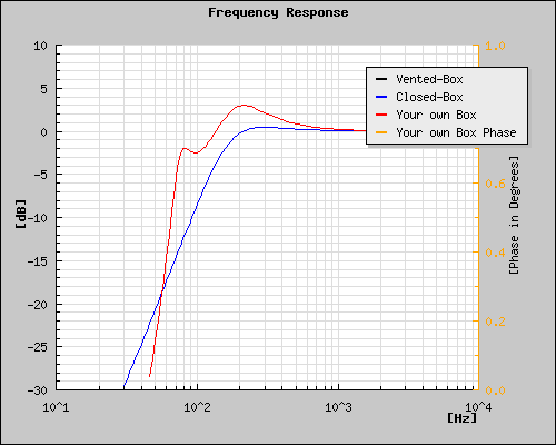

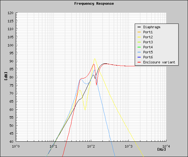

1) Foxtex recommends a Double BR box. I've tried modeling this using an on-line calculator at Lautsprecher Gehäuseberechnung mit Thiele Small Parameter. The results show a surprising amount of bass extension (7dB down at 60Hz), but the DBR typically produces a dip in the response (see attached FR plot, red line). OK, the FR looks ugly, but the reality may not be as ugly as the simulation and some who have built this say they are pleased with the results. Other options include the double chambered design of Weems/Augspurger but with 3 ports in total it's all getting a bit complicated.
2) I've also considered an Onken design, following the lead of the uFonken. This means aligning the box for extended bass shelf (EBS) by using a larger enclosure. I made some progress modeling this (see attached FR plot, redline); 5dB down at 70Hz. This model is based on a Vb of 4 litres. The total port area is 25sq.cm which is good because it's within the recommended (by some) range for an Onken of 85% to 100% of Sd. This pushes port length to the range of 25 to 35 cm which is also recommended (by some) for an Onken .
With a high Qts driver any kind of sealed/vented box solution is going to have some rising bass response, but I figure this will be handy in the fight against baffle step losses. Perhaps this peakiness from the FE83En may be just the ticket.

I can't come up with an alignment i'd use for a miniOnken (i'd never base one on your sim). Close as i could get generates a model with a +4 dB shelf from ~130-200 Hz, F3 of 100. Starts exceeding xMax at ~1/3 w below 200 Hz
Best non-exotic bet for this is 5 litre sealed, F3 170 Hz, F10 95 Hz.
This thing is really a mid-tweeter (as one would expect from Fs = 165 Hz).
dave
