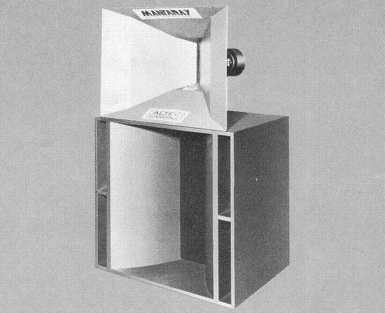

Not to worry, sir. It is still just on paper, but fleshed out a bit more. Imagine a big 3-foot plywood cube (final version will need to be somewhat smaller).
Now imagine that one side of the cube has a Mantaray-esque horn, loaded by an 8" Fostex. The remaining box interior is what's left for the BR part, with a port out the back, corner loaded. You could think of it simply as a big, dumb cubic BR with a waveguide for some directivity.
All dimensions strictly ridiculous at this point!
