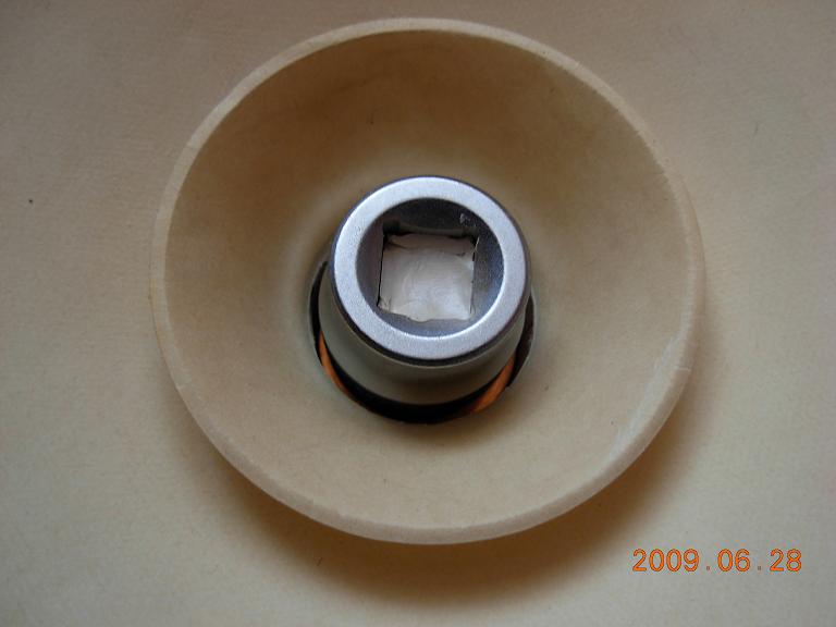

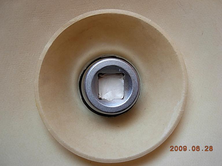

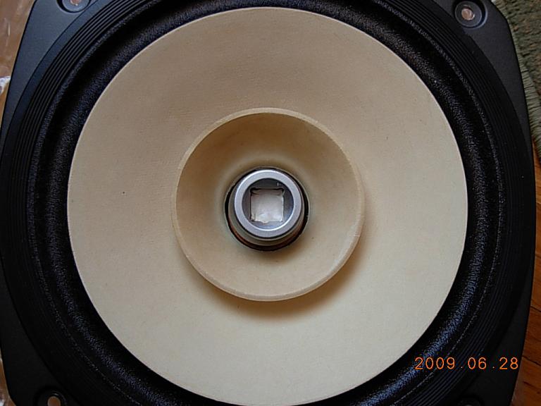

Upon seeing this thread it came to my mind that I have done a couple of wrong things with my Fostex FE206E drivers:
1. I had applied one coat of dammar
2. Being impatient, I put wrench sockets as phase plugs (like Decware's)
Needless to say, after an initial euphoria, it became apparent that it did not work as it should. Sound became more edgy, and the socket didn't do much justice to it, partly because the metric diameter of the socket is smaller that it should be, and the gap between it and the voice coil too big. Since the magnet holds the socket very firmly, I was afraid to forcefully remove it...
So, what I did? Nothing :bawling: I bought another speakers, Visaton B200's which I use today in OB's...
Fostexes are sitting in a box for more than two years...
Is it possible to rescue them? Would applying a layer of puzzlecoat help? And what can be done with the socket and that gap...?
Thanks,
Vix
Vix...
You have nothing to loose with some experiments. A layer of puzzlecoat won't unstiffen the cone, but it might damp it and counter the damar. Damar on the whizzer probably isn't a bad thing. The end of the socket you put an extension in is sticking out, a tight fitting extension should allow enuff torque to loosen the magnetix grip & pull the socket out. Your dustcapectomy could use some clean-up -- i use 100 grit sandpaper.
dave
