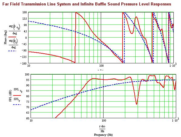

Below, you'll see the frequency response of the Lowther Club of Norway cabinet using the FE206E calculated in MathCad, assuming 0.25lbs to the cubic foot of stuffing from the top to just below the driver. The FE207E in this enclosure looks almost identical, give or take a db or two. If you really must, I'd advocate the FE207E however, which is more suitable for a responsnat enclosure like a TQWT because its response curve above 10Khz is substantially flatter than the rising response of the 206, and it will therefore require less correction. You can still use the 206, but you'll need larger values in the correction circuit, which will increase the cost, and why make life more expensive than it has to be, I say.
if you want to use these drivers in a TL, go for either Martin King's MLTL project, pay the small asking price for Bob Brines MLTL plans, or design your own in Martin's MathCad software. If you want a TQWT taper (and why not?), try something around these starting values:
Line length: 60"
Driver mounted at 1/2 line length
Top area (So) = 1Sd (driver surface area)
Base Area (Sm) = 5Sd (or more if possible, though this will mean a big cabinet)
Vent or port: circular, 4" up from the base 3"x2" (width x length).
These are rough starting values -they're probably not great in themselves, I haven't tried it, but they'll give you somewhere to start, and the response will be a lot better than the 'Voigt pipe'.
