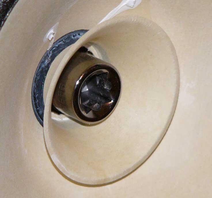

i still think the most worthwhile tweak i made to the smaller cousin of the 206e (the 166e) was adding a "socket" phase plug a la Steve Deckert. It subtly (subjectively) reduces peaking but improves off axis response and makes the driver more listenable
See pic (the powdery stuff is dried up damar)
