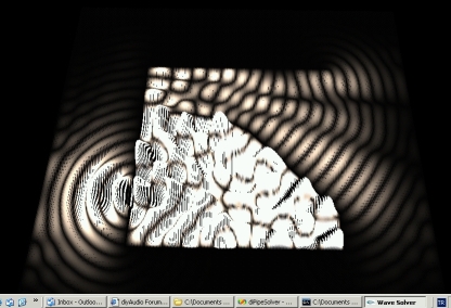

I wish I could show you my simulation result but I am working on to code a *.avi output of my simulation code.
All I can tell you is, midrange or the frequencies, which are causing reflections in the rear chamber and radiating back to the listening room from the thin cone of the speaker unit, are originating from the sides of the driver. Therefore it is better to cover the side panels with absorbing materials rather then rear panel. Also, rear panels of these enclosures are far away from the driver unit as compared to more problematic ones.
As for the "<" shape, the wave length of low frequencies are very long and that "<" brace is invisible for those, according to my oppinion.

Just an idea, since damping in the chamber is problematic also. Re low frequencies, I don't believe they are a factor because I'm not sure they can really even reflect in such a small space due to the long wavelengths.

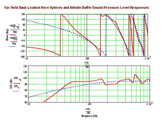

Sorry it’s been a couple of days –work's been a pain.
This is what MathCad predicts based on the information you've given, and a few guesses based on these and the drawings on your site. For a more accurate model, we’ll need a few extra things: the exact area of the closed and the open ends of the chamber, the depth of this chamber, and stuffing density (if applicable).
