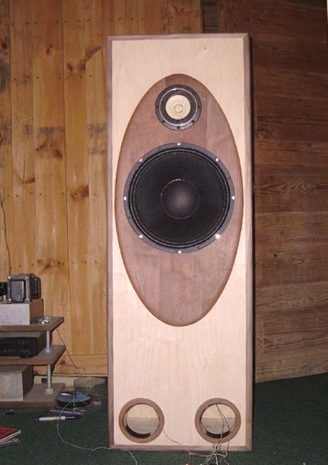

Another option if your happy witht the midrange/treble of your 108's is something like this which I just built. Certainly takes care of the low-end "weight" as it were. Lots of options:xeye:

Yeah they're the speakers I was telling you about. I probably won't document them, as in make a web page, or anything like that. I've posted a little bit about them on the fullrangedriver forum. I think I probably told you all about them at my brother's house, but I'll tell it again so as to share with everyone else 😀 . The fostex 108's are in a 2.5 liter sealed enclosure placed inside a MLTL with an Ememinence Delta 12lf. The fostex is crossed over at 600Hz first order, and the ememinence is crossed over at 300Hz first order to take care of baffle step losses. I'm still messing a little bit with the cross over. So far I've got that, plus a zobel on the ememinence, and about 1.5-2dB of dampening on the ememinence via an adjustable l-pad. I'm quite pleased with them. They still image great, and I don't feel as though I've lost anything in the midrange by crossing the fostex over so high. They also go quite a bit louder, and carry more bottom end than the fostex ever had on it's own. Hope I'm not doing any thread hijacking, but everybody likes to talk about their babies:angel: .
