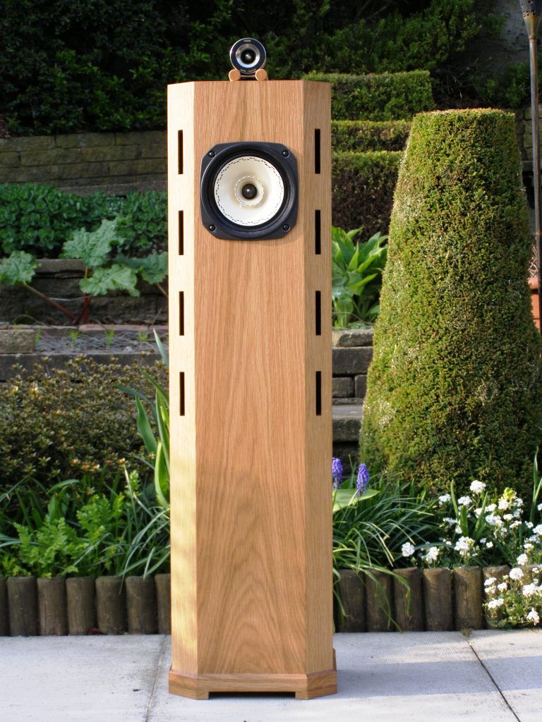

Sorry to disappoint but the 2-pr of EnABLed FE167eN drivers I have are not for sale. One set is installed in my Fonken floorstanders and the others are with my Son in a pair of Scottmoose MLTLs. Though I must admit I have been distracted of late with the very aimiable Tang Band W8-1772 drivers in some BR boxes based on the Bob Brines FB-20 design but modifed for the TB drivers, and a modified version of the TT-2000, I still enjoy the Fonkens floorstanders (photo attached) and was in fact listening to them yesterday albiet with some assist form Fostex T90A supertweeters to help out at the top end. I must admit, not having listened to these for quite a few months, I really enjoyed them even though the bass is not quite as low as the TB's but very clean and punchy never-the-less. They are still wired up now and I shall be listening to them later today after I have taken the wife shopping.🙁
Not to steal the thread but Dave (Planet10) would the MA Alpair10 be a suitable candidate for the Fonken167 floorstanders if suitable modified? I ask this as I don't have the software (or knowledge) to redisn the cabs for the A10's. Also from what I can gather the A10's may require a smaller cabinet in a Fonken style cabinet than the FE167e, yes?

The current Alpair 10 fits into a miniOnken of half the volume of the Fonken167. Like the F167 one would need to add a false base/stand to the bottom. The extra volume would give more versatility to add optional woofer(s).
One could of course do a squared version with 2xAlpair10 with a top firing unit. A front firing unit could well work too.
From the data Mark posted, the Rev2 A10s will drop in, the round coil being very close, the rectangular one loosing a bit of bass level, so a bit of retune is probably warranted... we'll see where actual production falls, i don't think Mark has finished refining the details. Give me an opportunity to improve the aesthetics from what has been done for the Mar-Kel, CHR-Ken and dMar-Ken.
The Alpair12 (nominal 6.5") seems to want the same miniOnken volume as the A10 (nominal 5.25"), so it is taking a bit of creativily to make a box that doesn't look like a chopped off cube.
