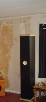

OK, here's a pic, not the best I know, I'll get some proper ones in once I've finished the speakers externally (stained the plinth and top moulding) Excuse the room, I'm half way through red-ecorating the house... Again... I get speakers, the mrs gets wallpaper, I'm happy with that.
I should give my honest impressions now I'm out of the honeymoon phase 🙂
The BIBs are a very nice sounding speaker within certain parameters (I said I was picky earlier)
On well mixed material they work amazingly well, with badly mixed material they accentuate the badness (perhaps I'm being unfair, it's not really the speakers fault after all)
The bass has good extension, very much present after the speakers I had these drivers in before. Initially I think I had them over damped at the bass so I was getting more of a 50-60Hz rise out of them which, though pleasant to hear bass again, became a little grating and boomy over time.
I've readjusted the stuffing to get a more even response to my in head measuring equipment (although it could have been a placement issue, I haven't RTA'd my room yet)
So now I have a flatter extension but it's a little thin for my taste, I'm going to try the inline resistor and cap if necessary. Corner loading would help this too I expect.
I understand now about tuning the speaker to the room.
Vocals are stunning, I was listening the other night and the mrs was sitting on the couch between the speakers, I swear Ben Harper was singing out of her. I should have got her to move her mouth along with the music... Heh heh.
The speakers definitely disappear nicely with correct positioning, very happy with that.
I still have a little heat in the upper mids to tame, damping the basket etc with blutack helped a lot, I think perhaps phase plugs will help more in my room. Or maybe lifting the bass will help make it less obvious.
I've never, ever heard anything produce a sense of space like these do ! Absolute magic.

Hi, I just played around with Inguz DSP EQ on the Squeezebox again, adding 2db from 200Hz shelving down to 0db at 50Hz
Everything suddenly sounds smoother, even the previously hard to listen to stuff.
Would this be the same effect as if I added the series resistance at the expense of a few Db of efficiency ?
From what I've read a resistor by itself in series is to reduce a constant rising FR ? What is the difference between this and a BSC ?
How does the resistor know where to start attenuating ? Is it simply making the speaker a harder load to drive for the amp ?

Yes, it's a similar end result to adding some series resistance in the LF regions anyway, except the resistor will have an effect on the entire FR, not just the bass frequencies. That answers your other question re how does it know where to start affecting the response -it doesn't; it affects everything. Basically, it artificially increases the Qe of the driver while lowering Re & Bl slightly.
Baffle-step compensation is completely different. A passive-circuit is used to attenuate everything above a specific freqency determined by the baffle width, due to the transition from 2pi to 4pi radiation of all freqencies below this point, resulting in a 3 - 6db loss of SPLs at the listening position. If you have active Eq, you can do the same, or boost the LF (better IMO to cut down to reduce driver excursion). The BIB doesn't need it -it's got sufficient gain from the cabinet to counter the losses.

Sorry to be a pain, before I go out and buy resistors, do I need to get a certain wattage ? I don't want to blow anything up ? I can series/parallel a bunch up to make x wattage at 2-3 Ohms. Will getting them at too high a wattage cause any issues ?
I was going to play safe and try and make it around 30w.
Is that enough ? Too much ?

Kinda talking to myself now I think, but if it helps someone else that's cool...
Right, BIBs, I failed to mention the bay window in the middle of the wall where the speakers go. They only butt up against the wall on one side really, the other is empty.
I moved them back out wider tonight and the bass sorted itself out again.
Sigh, they are a bit wide for solid imaging, but much greater depth and smooth listenable presentation.
I think I need a new wall 🙂
OK, I REALLY should have mentioned that in the initial postings...
What can I do ? Stay with DSP EQ and move the speakers closer together but feel a bit cheated.
I'm thinking I'll wait for the Chilli Chang and have a go at them, would they would provide enough non boundary required gain ?
