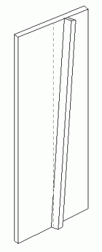

oodi said:am having difficulties envisioning the vertical bracing, could you elaborate please?
Take a piece of ~ 2" wide 3/4-1" plywood or hardwood. Use an appropriate length to divide the panel into 2 long skinny unequal trapezoids.
pictured below in its simpliest form -- if you can extend it to reach the other side (make it holey of course) then even better
dave

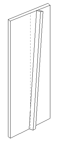

Vertical Bracing:
Once you have your panels cut out. You need to attach a brace to the inside of the cabinet. I have cut a 3/4" wide by 1/4"deep stopped dado channel in the panel. divided the panel width by the root of 2 to determine the approx. location. Stop the dado before you get to the end so it will not show on the end. Cut a 2" by 3/4" strip of hardwood or 3/4" baltic birch ply. Cut the length to fit inside dimensions. insert and glue. Ta Da you made a vertical brace. Another way is to use a biscuit joiner and do the same but do not cut the dado channel. If you use the biscuit idea you do not have to keep the line vertical you can skew it off by a bit on one end. You need to use a good quality wood glue to secure and clamp tight.
That should help you understand the concept I hope

Dave is quicker than me on the response:
Dave also eludes to our favourite technique. If you extend the brace to the other side you can reinforce both at once. You can also cut out a place for the back of the driver to be braced as well. You have to drill a lot of random holes in the bracing pannel and acount for the approx volume change by the bracing pannel. I have used 3/8 or 1/2 inch plywood for that. I drilled 2.5, 2, 1.5, 1 holes though out the bracing pannel. The trick is to dry fit and cut out for the driver brace part to be pretty close to exact. It is better to be a bit ( ie less than 1/8") deeper than shallow. You can use good old duct seal to make up the differnce between the driver and the brace.
I hope this make sense
