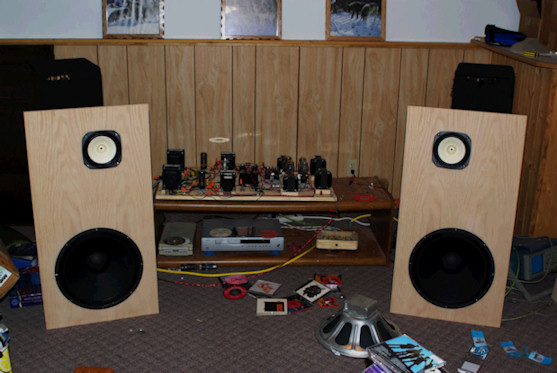

fe167e and Alpha 15a OB arrived
just got going a fe167e and Alpha 15a OB. Thanks MJK for your website.
sounds great so far and running them both fullrange till i get the x-over built. even with no x-over sounds very very good.
very open and airy. detailed. relaxed sound. bass is good for a passive ob.
probably go with the x-over MJK mentions if no one has anything that would work better.
maybe go with those phase plug things also.
any ideas for x-overs?
pictures to follow probably.
pic
The only potential problem I see with your set-up is that the FE-167E is 94 dB/W/m efficient and the Alpha 15A is 97 dB/W/m as predicted in infinite baffles. My original design targeted a 90 dB/W/m finished system efficiency with a smaller full range driver. You will need to be careful with the crossover to get them to blend and produce a flat SPL response. Maybe allow the FE-167E to run full range and only crossover the Alpha 15A so it helps offset the open baffle roll-off. Or maybe pad down the FE-167E a few dB and crossover both in the 200 Hz range similar to the original design with the FE-103E. The default set-up in my three driver OB worksheet uses the FE-167E and two Alpha 15A drivers and it is predicted to work extremely well (see the pdf on my Models page). If you can handle the level mismatch correctly, I think your system will be outstanding.

Crossovers are Linkwitz-Riley 12 dB/octave. You can use the lowpass part from MJK's design. For highpass I suggest you use my values from 'The Volks-OB' :http://www.audiocircle.com/circles/index.php?topic=46951.0 , 30 uF Obbligato capacitor and 8 mH inductor. Obbligatos are available from DIY Hi-Fi Supply and are really good and cheap: http://www.diyhifisupply.com/diyhs_ob_caps.htm. The L-pad could consist of 3.3 ohms in series and then 11.5 ohms over the Fostex, that should give an unchanged 8 ohm impedance for the crossover.

The values are OK. But alternative L-pad values of 2.7 and 15.5 ohms will give 3.6 dB damping which may be a better solution to start with and adjust further if necessary.
If you would go for cheaper high-pass you could choose Dayton DMPC-30 30uF 250V Polypropylene Capacitor at Parts Express(which I don't know the quality of) and later upgrade to Qbbligato if you are not satisfied.
