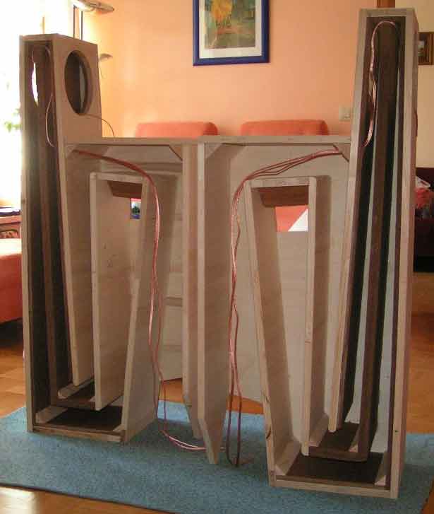

Hello pwan,
if you look a the Xmax (0,6 mm)
for me only a horn will do it:
http://www.hm-moreart.de/7.htm
a new double horn, down to 32 Hz,
with a 2 driver like the 167 AV at the back
free download, part list direct from me.
