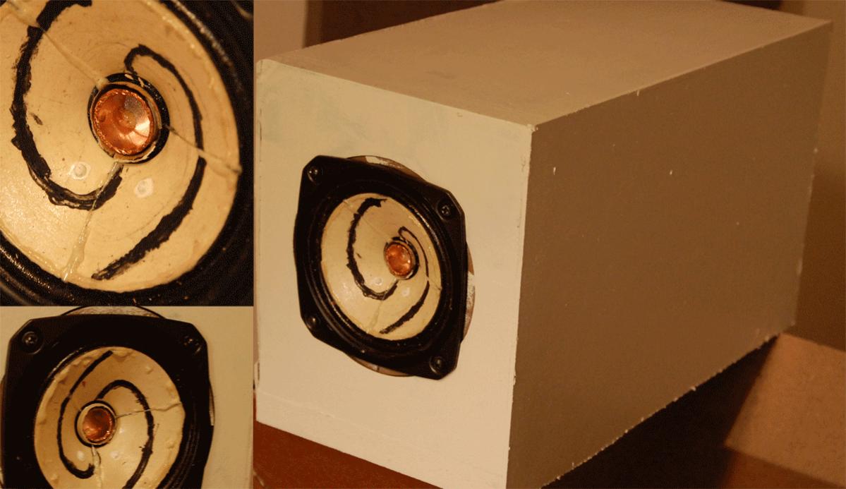

FE127E speaker with modified driver
not bad sounding speaker.
paperclips are inserted between cone cuts and glued with gorilla glue.

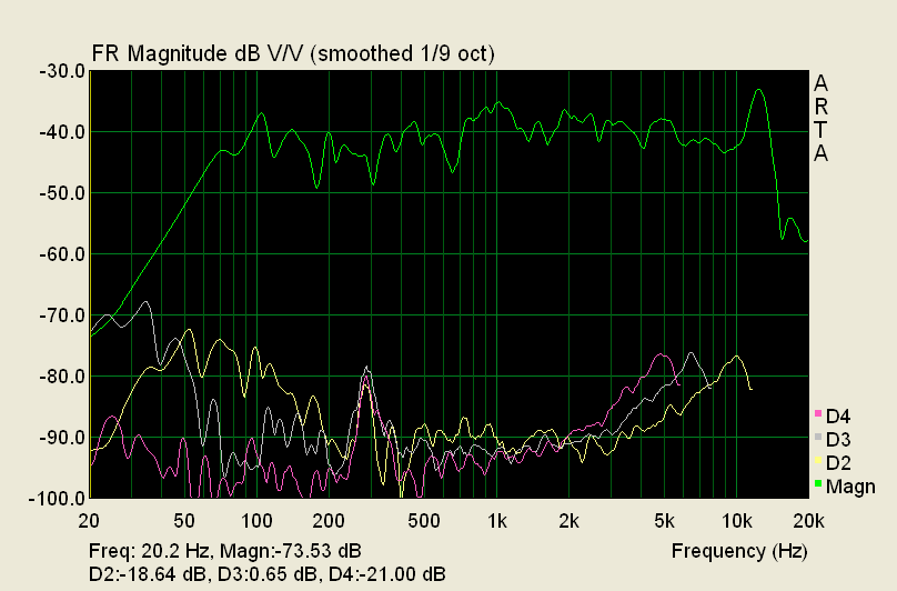

0.6mh inductor is used for BSC
measurement mic distance ~12in
