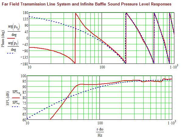

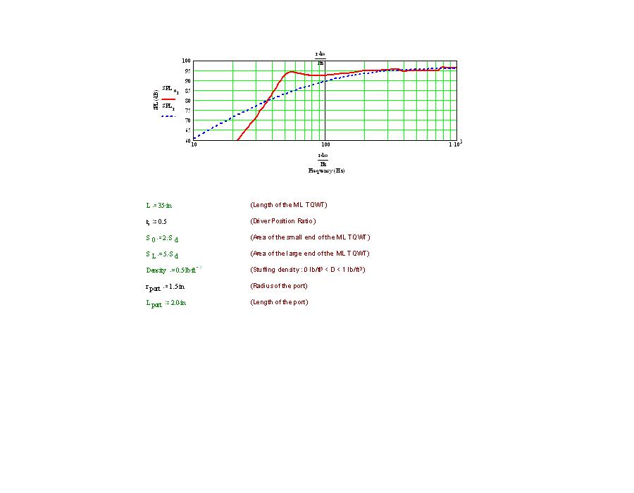

I have modeled the TB driver in mathcad using a bipole MLTL configuration. Could you guys take a look and offer any suggestions you might have? I think playing around with the stuffing some could help smooth the higher frequencies a little bit more...
I have attached an html version of my modelling. The worksheet is too big to be attached.
Oh I apologize. It worked on my computer, but apparently I forgot to attach the images with the file. however with the images I cannot get the file to be small enough to be uploaded to the forum. So here is the information that I have inputted into the sheet:
fd=75 hz
re= 6.8/2 ohms
lvc= .01 mH
Bl= 4.8 N/A
Sd= 2*.0057m^2
Vad=2*5.99 L
Qed=.48
Qmd=1.5
L=35 in
position = .5
So= 48 in^2
Sl= 48 in^2
Density = .5 lb/ft
rport= 1.5in
lport= 3 in
This is supposed to be a bipole MLTL so that is why some of the values are doubled or halved.
and stelleg151, doesn't the fostex have a very limited xmax (.35mm). It seems to me that even though it is more efficient it may not be able to handle enough power to bring it to appropriate spl levels.
Frequency Response from mathcad
Should I be worried about the ripples in the higher frequencies?
Only if you forget the stuffing.
