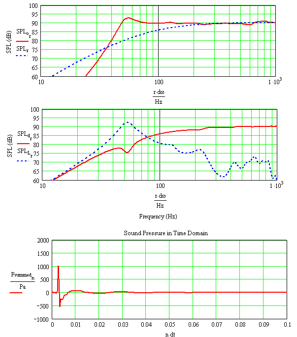

I'm right now also designing an enclosure for FX120 or FE127E, but it looks like a larger TQWT ( almost 1m tall). It should go down to 50Hz -0dB with the FX120, maybe a little more with Fe 127e. I'm now waiting for the enclosures, which a friend of mine will build for me (he's a carpenter 🙂)
Here are some sims I did for this enclosure. The hump is not an issue, it is there to :
1) help keeping baffle losses minimal
2) in a small room, the energy from the hump is "redistributed" at lower frequencies (look at my TangBand designs if you are not convinced)
Good luck with your speakers !
I keep the internal dimensions "confidential" until I know how it works 😉
I designed it around 3 main goals :
- maximal bass extension (hence the large cabinet)
- clean impulse response (hence the TQWT choice)
- very low midrange pollution trough the port
and finally I gave up the horn solution, way too big in my bedroom 😀
The external design is 960mm (tall) 350mm(deep) 200mm(large) so it is much larger than GM's design ! I hope it will get me all the bass possible from my FX120, these are promising drivers (2mm Xmax, not bad compared to Fe127's 0.6mm).
I'm very impatient to hear them !
