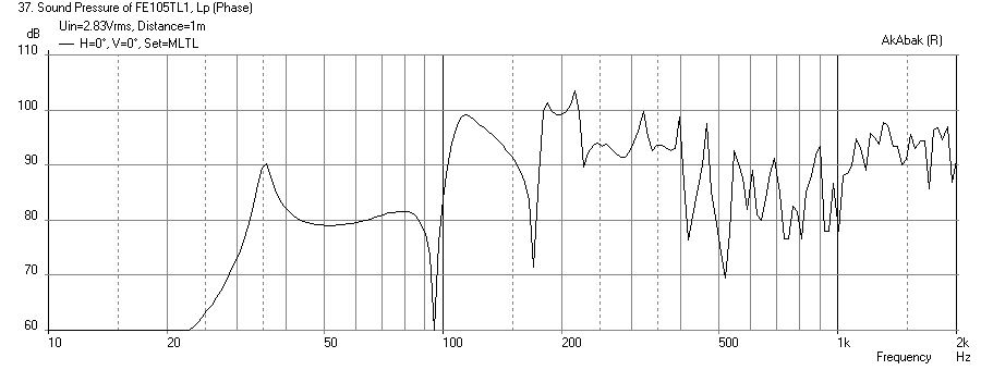

The TL that you see on the video may look cool, and the guy is a good wood worker, but I believe the sound will not be good. A typical open ended straight line like that will have a lot of peaks and dips and big gain at one frequency. You should look into a design that has been modeled and has been built on this forum for the best bet in good sound. A Voigt pipe or MLTL will give the cleanest sound, the BIB can work but will have a rougher looking frequency response. This may work well in a rear facing horn.

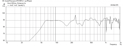

I ran a sim of the TL shown in the video based on estimated dimensions of 4 x 5 in CSA x 80 in long with an open end facing front. The results are not very pretty, it may go deep to 30 Hz as the guy on the video says but at the expense of smoothness of the frequency response which has a big hole right after the 30 Hz peak. Next, I optimized it as a MLTL and find that you can't really push the FE103EN much below 60 Hz, however the response is much better. The design is as follows: 5 in wide baffle x 7.5 in deep x 31 in long, driver at 6.2 in from top, vent is 2.75 in dia x 3.75 in long located at 9 in from bottom and front firing. With stuffing in top 2/3rds, all those little dips and peaks in the higher frequencies should smooth out. There is a 0.6 mH x 3 ohm BSC included here to tame the high end.
