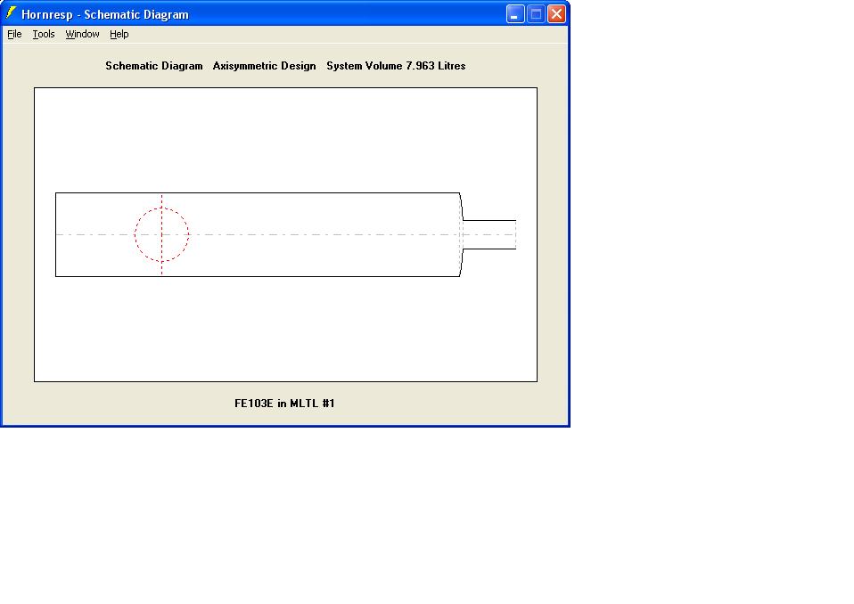

I should put out a few more of the background aims/compromises here so it makes more sense -
I want to (i) use the FE103E's ( finally ! )
(ii) improve on the crappy built-in TV speakers without building something too elaborate or big . Single-driver is nice for the improved vocal rendition over 2-way .
(iii) Try out a new sort of enclosure as a trial for a bigger unit for the HiFi
(iv) Use the 103's for some first efforts at EnABL , with Bud's help .
After a lot of playing around on Hornresp ( I have it and know how to use it , haven't got up to speed to find Martin's programs so far ) , I realised that there isn't much to choose re. driver displacement between TL, TQWT and ML-TL , around the 100Hz area . I guess I can only control driver displacement by firing into a small space or using horn loading, so that efficiency goes up . As it is, I should get 80db/1m @ 100Hz , so that's OK for TV .
The MLTL looked best for resonances so I tried to refine that as best I could . I have a design and will likely launch into some wood-cutting this weekend ( free weekends need to be grabbed with both hands ! ) .
If anyone wants to lob this into Martin's software and let me know if it's going to be a disaster, please tell me soon ! Thanks .
Hornresp listing attached - hopefully it's clear - just a parallel pipe, offset driver, with a short slot vent at the end .

If compact is on the short list of factors for your calculus, Dr Lindgren has drafted (I mean modelled with MJK's worksheets, I believe) a quite flexible folded TL/ labyrinth design for 3- 4" drivers, of which I've built pairs for several models. They work quite well with Mark Audio A6, Fostex FF85&105, and I'd not be surprised if one existed or could be calculated for the FE 103- just don't expect the same LF performance as with the WKs- which are the best value in the current Fostex line for someone not wanting a BLH for the 126E, AFAIC
