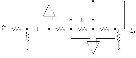

Is this FDNR topology so rare that NOONE has come close to it? I'll guess I'll have to simulate it when I have got the time.
This is one way to solve it but "the circuit" is a simulated inductor. The weird FDNR caught my interest so I wanted to use it also. Nobody will see the difference but I will.

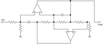

Since overkill is my brand I thought it would be cool to design a well-made ultra universal filter but this is a rather big project so I'll guess I can't make it this week. Seriously, I have thought about it 10 years now and time to time it pops up in my brain.peranders said:I have small plans to make a really cool cross over filter. I had in mind, 2nd, 3rd and 4th order LP sub, LP, BP and HP filter. Super universal with universal charateristics, Chebushev, Butterworth, Bessel (anykind) etc.
It seems that FDNR is a totally unexplored field. Maybe we should explore it for hifi usage?
The opamps I think of here are AD8620 and OPA2134. The opamps have to be dual (=matched), so have I been told.

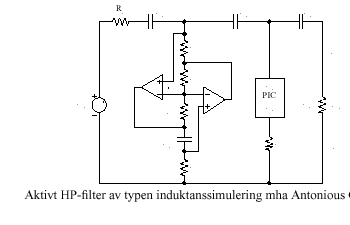

Search for "GIC" in browser...You will find something like this......
A possible solution is to use GIC as an inductor but the goal was (if it's possible) to have an all-FDNR filter.phase_accurate said:But I don't see any reason to use sophisticated circuitry that can be run ungrounded, only to substitute a simple cap.

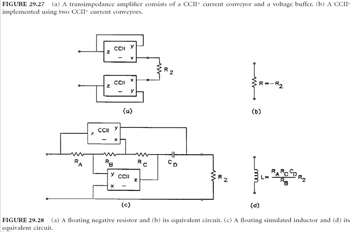

Here's a floating Current Conveyor, from
http://www.kemt.fei.tuke.sk/Predmety/KEMT350_EP/_materialy/ch029.pdf
it's in part 29.3 of the article:
FDNR's are impossible to use a highpass filter but I can use the same style simulated inductor instead.
jackinnj, please note that your example is a simple negative resistance, not frequency dependent.

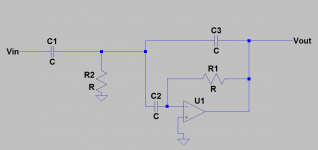

I used a 1 op-amp grounded FDNR on my crossover page, and also a 1 op-amp grounded gyrator (inductor simulator).
One-end-is-grounded one-opamp FDNR's and gyrators use 1 opamp instead of 2, which is very useful for shunt legs on filters; its downside is it has a parasitic shunt R (in the case of the FDNR, series R in the case of the gyrator), which, with careful design, can be rendered insignificant.
I used it to great effect, reducing my opamp count, over the 2 op-amp gyrator/FDNR, and it is far less sensitive to component tolerance than the biquad type of zero-pair implementation (according to Spice Monte Carlo analysis).
With 2 opamps I achieved a 4th order elliptic filter (4 poles, 2 imaginary zero pairs). By configuring the opamp as a unity gain follower, open loop gain isn't that much of an issue, depending on the exact topology (e.g. if the impedance you need doesn't need to go very high); what you have to watch out for is the load presented to the opamp and the opamp input impedance (you usually need FET input opamps). The effect of open loop gain is apparent if you simulate gain = 0.99 (which is with open loop gain = 40 dB). (Ditto for effect of input impedance, on circuit's required max impedance).
