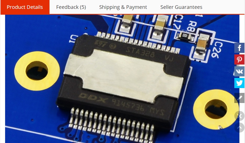

If you compare the STA326 datasheet with the datasheet of its original design by Apogee you may notice that the output filter was supposed to use different inductors for different speaker impedances. It appears that D8 uses a castrated version of the filter intended for 8 Ohm speakers. I can only hope that ST Microelectronics did their homework when calculating their own version of the filter as seen in their datasheet, since it is different from the one given by Apogee and does not mention various options for various speaker impedances.
D8 uses STA328 (datasheet dint offer additional inductors values, although specs-table indicate support 4~8ohm speakers impedances), while STA328 application design reference 8ohm speakers
I don't see much difference between them in those datasheets. Are you sure your amp uses STA328? Some French guys disassembled theirs and showed STA326 inside.
As mention, though STA328/STA326 datasheet specs 4~8ohm, but test application (pg 7) dint offer any inductors options. However Apogee test application has inductor options for 4/8ohms.
Alientek D8 specs pages shows using STA328. I would not want to dismantle , otherwise results STA heatsink's screws markings showing tampering.
(until i can test use device is functional without hardware defects)

Okay, I finally killed that nasty hiss of my D8 and not by restoring the STA326 filtering circuit to its datasheet glory (although I did that too), but by inserting an inductor, as large as I could immediately find which turned out to be 15uH torn out from some dead piece of hardware, between the input power line and the 5V DC-DC converter (it operates at 2 MHz). So, the chief culprit appears to be the usual one - a dirty power source, in this case dirt is produced by D8 internally, hence it can't be eliminated by using even the best possible external power supply.

So i think, there exists some D8 with STA326 & the newer D8 with STA328.
For me, the important thing is to modify the output filter, because my loudspeakers are 4 ohms and the filter is designed for 8 ohm speakers (refered to DDX-2051, 8 Ohm - 22uH 470pF).
