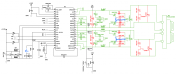

I've opened my Alientek D8 and discovered (rather unsurprisingly) that it has much less discrete parts than recommended by the STA326 datasheet. In the attached picture those omitted are colored red, those present are green, and in blue I colored some changes in the schematic which I noticed. I did not check SMD capacitors, hence their actual values are unknown to me.
Guys, do you think it's worth trying to restore the scheme to the version intended by ST? Will it improve sound quality and maybe at least lower that horrible hissing noise which is audible a meter away from speakers?

This is a low budget solution chip, for teenagers parties or similar, it is function rich, but in the sense of including a digital limiter for protecting boomboxes and budget 2.1 systems from overload, keeping decent sound when loud. It also allows some trade-offs in speaker driver selection with DSP and some biquads per channel.
The datasheet shows 0.1% THD for non-bridged operation, and not better than 0.03% for BTL. High noise was probably allowed in design process. 100dB SNR is stated, but there is no noise floor plot, there could be a rising noise characteristic towards 20khz. Datasheet says something about 3-level modulation, this surely involves a trade-off for increased noise.
The thing they call DDX is also another trade-off for noise, going to analog with a CODEC, and then amplification, achieves 112dB SNR easily without noise increase at HF, so the thing called DDX is involution rather than evolution, for cost reduction.
There is a third factor, there could be HF peaking due to no post-filter feedback, and this could be solved by looking at output with oscilloscope while connected to speakers, feeding 10~20khz from a signal generator, low amplitude, and tuning a series RC in parallel to speaker to flatten the HF portion of the impedance, where success is observed as no peaking when sweeping from 10khz to 20khz.
There could be a fourth factor: Self interference, but being a chip from ST, the self interference limiting factors are probably inside the chip and not in this PCB implementation.
The parts omitted have to do with optional EMI filtering on outputs, but this is far more related to disturbing other equipment than to self disturbance.

yes the snubber filter on tp1 it s a very good idea. i tested on v200 and on d310. the sound is very much much better.
snubber filter
v200 tightlight without snubber. with snubber is much better.

Okay, I finally killed that nasty hiss of my D8 and not by restoring the STA326 filtering circuit to its datasheet glory (although I did that too), but by inserting an inductor, as large as I could immediately find which turned out to be 15uH torn out from some dead piece of hardware, between the input power line and the 5V DC-DC converter (it operates at 2 MHz). So, the chief culprit appears to be the usual one - a dirty power source, in this case dirt is produced by D8 internally, hence it can't be eliminated by using even the best possible external power supply.
Audeo, mind sharing some actual pictures of D8 improve mods you did?
can list partlist as well? Thks
globulegl mentioned snubber filter on tp1 it s a very good idea. I guess you are referring pictures provide by Audeo. Does Tp1 refers to Test Point 1 on PCB? Does D8 mods snubber filter refers the 660p Ceremaic cap & 10R resistor? What wattage is suitable for the resistor
Any other mods beside Tp1 is needed?

That schematic was taken from the STA326 datasheet and has nothing in common with Alientek D8 except the chip itself. "TP" must be "test point", I presume (and those do not matter here), and blue lines, as I said in my message accompanying the schematic, indicate not my doing, but that of our Chinese friends - it is what must be undone by some sheer and brutal cutting. You better find the STA326 datasheet and compare it to your actual board layout. You might well find some more discrepancies which were not there in my case. Resistors' wattage does not matter much, I think, because none of them carry any substantial current. I used some smallish SMD resistors everywhere, big enough to be easy to hold and solder.

So snubber filter at tp1 & tp3 dint help to remove the hiss?
Oh... I think wld just insert the 15uH inductor:

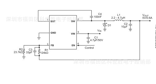

"Input power line" refers to the +Vin from the DC socket, and "5V DC-DC" refers to the 5V regulator +Vin, am i correct?
Even if it did, I did not notice it.So snubber filter at tp1 & tp3 dint help to remove the hiss?
Actually, the larger the inductor the better, I put a 15uH one there only because I had one at hand. But make sure your inductor can withstand current of 3A or more, just to be on the safe side. "Input power line" here is the wide lane immediately after the diode at the DC socket and "5V DC-DC" can be seen on the photo as a 6-pin SMD chip marked "IV7GK". See attached some schematic from Aliexpress showing its typical application.Oh... I think wld just insert the 15uH inductor:
