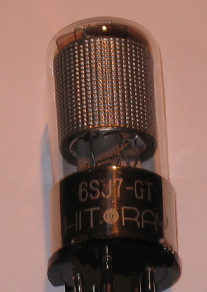

I guess this isn't my fav tube but I certainly love the look of it! I wish I had some more.
Shawn,

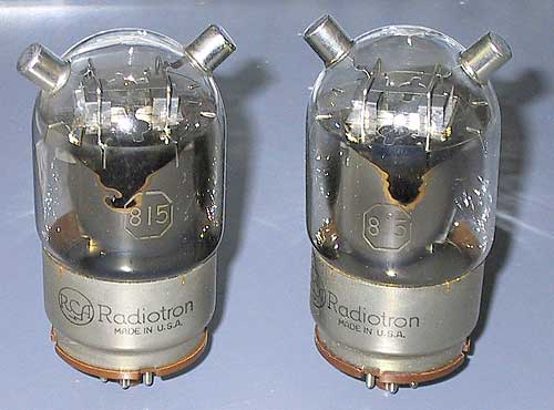

but the 815 is sure cute
I have seen some of those two headed aliens in the warehouse, but I haven't tried any of them yet. I have also found a smaller sibling the 7193 (I think). It is a two headed octal alien, with 6J5 guts inside.
