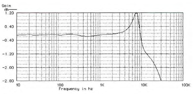

While for most wire I'd agree, don't kid yourself that there aren't any wires out there with RLC specs. that influence the audio band. For e.g., you may wish to peruse the attached. This is 10m of an old Siltech made ribbon wire, into a simulated load (of a Carver Platinum MkIV if you're interested, which was done with full knowledge & measurements of drivers & XO). The amplifer was a Boulder, very low output impedance, and driven direct at the terminals, this should be flat to >20KHz.
Equally, the 4-5ohms of series R in a custom Fostex wire of a few years ago does have a very obviously measureable effect on the response & behaviour of the combined amplifier-wire-speaker system, how much depending naturally on the spec. of the first and last mentioned.
Has anyone mentioned speaker cable causing an amp to oscillate. This is a real concern for some amps eg Naim. I can't imagine an oscillating amp sounding at its best
If the amp still works. The Polk/Cobra cable of the late 70s terminated the life of many an amplifier.
dave
dave
Totally un-excusable, for both the amp and the wire maker. Some amps don't put on the output filter. Big mistake. Some amps don't have protection circuits, also big mistake. ( thermal protection cannot touch the audio, so no excuses! )
