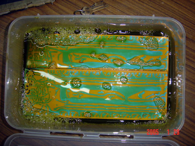

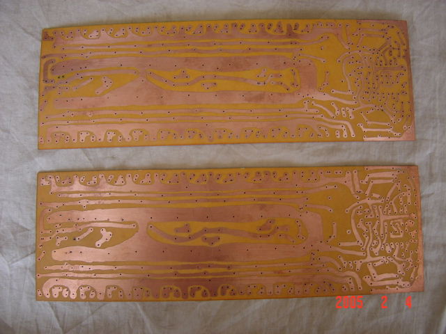

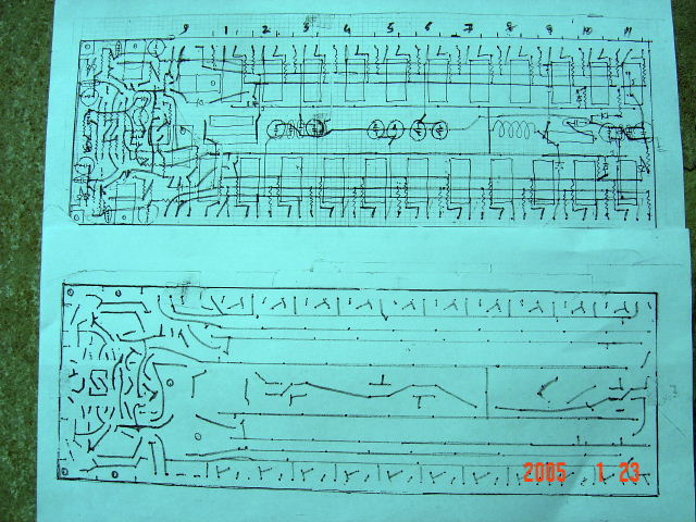

I have cut the boards and will be painting them with enamel paint soon.
K-amps

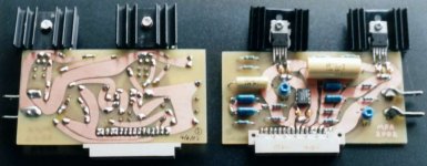

Yes it is looking like the holton boards the only difference is that he has
put the devices in the centre and I have put them on both sides .
Ashok

That is one heck of a lot of tedious work
Have you not considered investing in a UV lightbox? It only takes a couple of boards like that to make it worthwhile IMO.

It should do for testing out the validity of the circuit. It must be much faster to do it at home than to get it done out.
I'm sure not many people will 'see' that board.
DIY of course.
DIY of course.

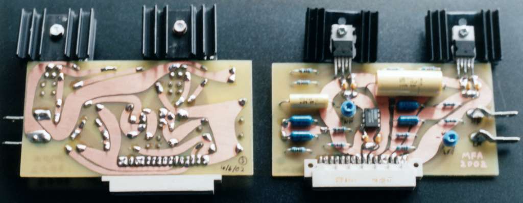

I hand draw my PCBs too. It's because PCBs are art!🙂 Plus it's about as DIY as you can get.Bill Fitzpatrick said:If I made boards like that I'd be too embarrased to show them to anybody.
Agreed. Mr. Luthra has toughed it out the old macho way.
Also Kudos to his courage to show it to us, not everyone has that level of self esteem and confidence. We wish him the best in his project. People in my country have usually no idea what people in other countries have to go through to support an expensive hobby like this, the fact that you are trying to do what you can is commendable. Afterall this forum is not for only for experts in a peeing contest, it is also for regular folks who love audio.
Rajeev, I apologize on our friend's behalf if any comments seemed out of place,
kind regards,
Tekko said:No. Using perfboard and thin wire is as diy as you can get.😉
I sometimes wire all components p2p without perfboards, THATS as DIY as you can get. 😀
Etching and drilling PCBs, YUCK
Perfboard as actually hardwire as you draw regular wire between components😉 Easier to get a nice looking layout too, also some components are desigend to work optimally when the board capacitances are present.
