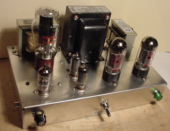

Well, I did get my new prototype done and it works like a champ, about 14 watts of nice hi-fi. After I tested the voltages out and triple-checked the wiring (and used old dubious expendible tubes first), I put in my new JJ & Ruby tubes, for the 6V6's, 12AU7 and 5U4, the only ones that are NOS are the 6AU6's, one of these is a new old Magnavox, the other a GE.
Ran it for 4 hours from an old late-80's CD deck, and it did well.

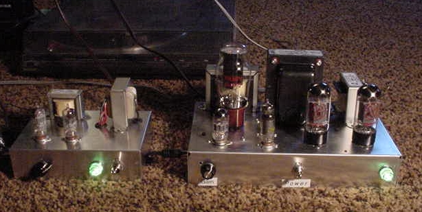

And running it on the living room rug feeding a turntable into the preamp first to get more gain:
