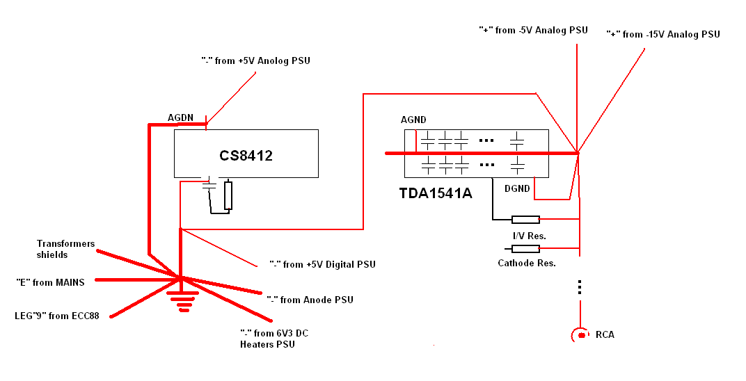

There is another concern , as looking for error I changed grounding few times and at the moment is pretty mixed-up.
Ground from Mains, transformer shields,"-"from Anode PSU, leg9 from ecc88, "-" from Heaters PSU and ground from DAC are connected to chassis in one common point.
Ground on DAC is made as follow:
1.analog ground bus under TDA1541 with all 0u1 caps connected to,
2."+" from -5V and -15V PSU's,
Pin DGND from TDA1541,
Pin DGND from CS8412,
I/V resistor and output stage,
connected to this bus at one common point,
3."-" From Digital +5V PSU connected to DGND pin -CS8412
4."-" From Analog +5V PSU connected to AGDN pin CS8412
Digital +5V PSU is common for TDA1541 and CS8412.

Hi, I would not connect signal GND to safety ground directly. I use a 100 Ohm resistor for that. Safety ground is for eh...safety. You don't want to pollute your signal GND with mains noise etc. The case and the transformer shields should be connected directly to safety ground though ( PE ). If you connect signal GND to safety ground directly you will make more problems than you want to solve.
Never understood this technique and never did it like this too but maybe somebody can give a good explanation why connecting signal GND to safety ground is wise choice as I can not find a single benefit. It will make ground loops enter your electronic life.
