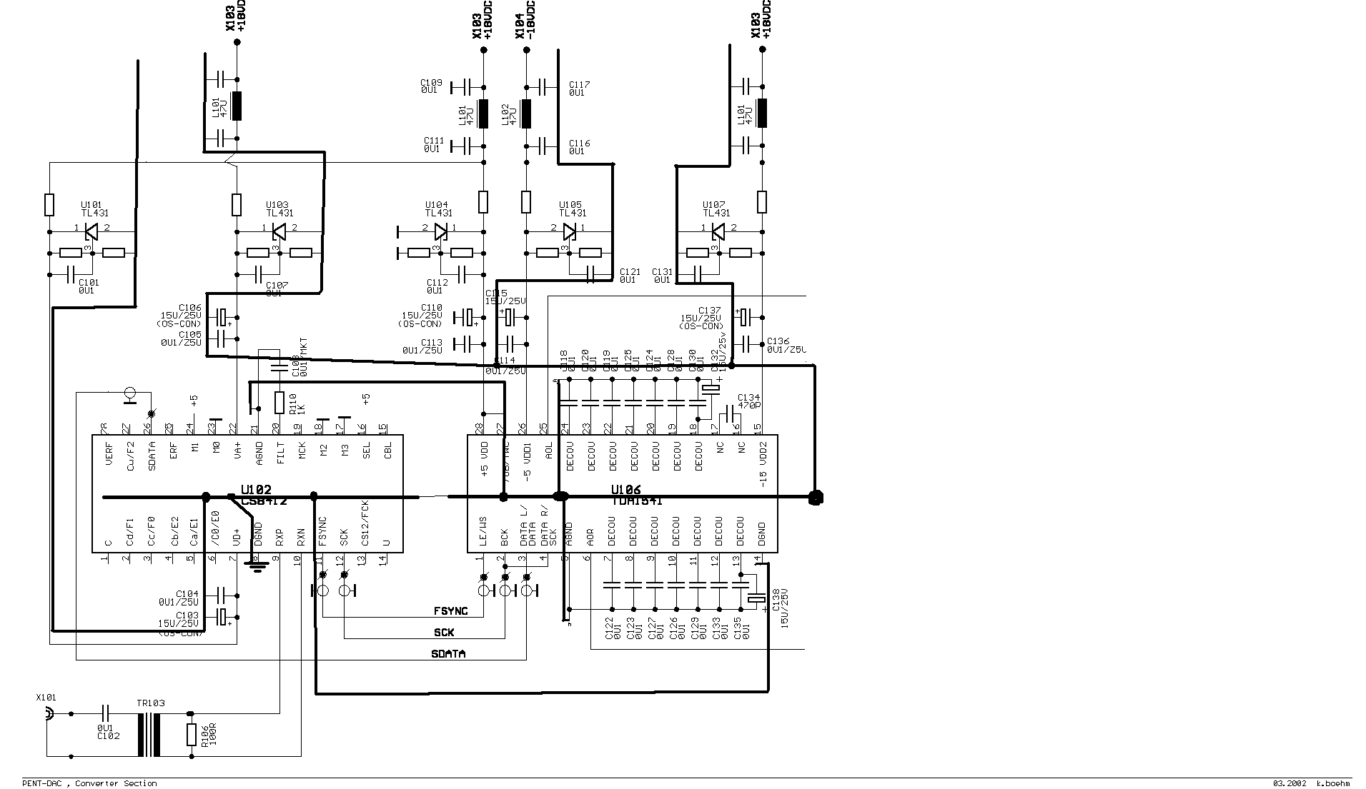

I have just finished tube DAC based on CS8412 and TDA1541A -Adagio schematic.
Problem is that voltage on TDA1541 pins Vdd and -Vdd2 are -0.7V(???) and -3V respectively.When disconnected from chip and shorted with resistors to simulate correct current as on datasheet ,voltage is as should be :Vdd=+5V and -Vdd2=-15V
other pins of CS8412 and TDA1541 are OK Vd=5V Va=5V and -Vdd1=-5V.
I wonder if there is problem with TDA1541?

Bought another one , this time from UK seller .
I have one more question , I have made 3 separate PSU's for analog supplies and 1 for digital.All analog grounds tied together and going underneath of TDA1541A, then decoupling caps plus agdn connected to this ground .
Digital Ground going underneath of CS8412 , dgnd and agnd from chip tied together also dgnd to chassis .Any suggestions ?

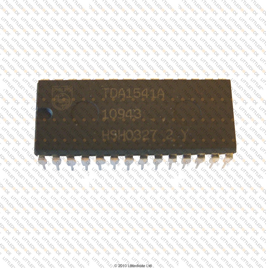

There are quite a few threads here on the subject. Search through them and compare pictures.
But HSH indicates holland and 03 would be 2003. Seems fishy. And since it's not working..
HSH = Kaohsiung Taiwan
Should have the 'line' on the left reading 'Tai wan', and no production in 2003. What I don't understand is why, if one wants to make a fake chip, would you print an impossible year/week/location combination on the chip?
Anyway, still fishy.
Shure? Seems you've changed your mind:
http://www.diyaudio.com/forums/digital-line-level/167927-genuine-tda-1541a.html
Most of the HSH pictures seen here don't have taiwan on the left (apart from one). RSH always says taiwan.
Always thought HSH is nijmegen, could be wrong though.

Hi Slav, I am shamelessly promoting my TDA1541A here. If you need original and good measuring/sounding TDA chips please send me a PM.
BTW no chips were made in Taiwan in 2003 AFAIK. The whole RSH/HSH issue is confusing as I have chips with HSH with the Taiwan logo and chips with HSH and no Taiwan logo. There were some batches made in Taiwan in 1997/98. Most recent chip I have is a version with laser engraved (modern!) markings and that one is from 2004. I was told the chip has been produced again because there is enough demand for it but since I can not track it down I don't want to burn my fingers on it. I file it under "suspicious" 😉
Wrong, I had a box full with original Taiwan chips with HSH code.

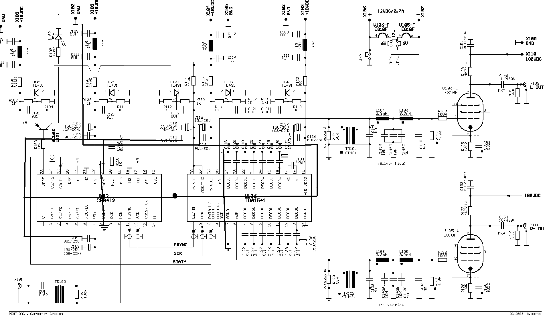

Hi
I need a grounding advice ,please:
1.as I have used pulse transformer , should I ground primary or secondary
windings?
2.Ground for I/V resistor should be fed from tube output stage , in order :
RCA sockets to common star ground ,then 1M resistor , cathode
resistor , filter + I/V resistor?
3. As DC voltage has been used , leg 9 from ECC88 goes directly to
common star ground?
4.And finally the bigest head ache - DAC board.
Analog ground under TDA1541 with all 0u1 caps tied to all grounds from
Analog PSU's connected to this bus + Pin AGND from CS8412 +pin AGND
from TDA1541
Digital bus ground under CS8412 , ground from shared Digital PSU for
TDA1541 and CS8412 tied to this bus ground + pin DGND from CS8412+
pin DGND from TDA1541
Pin DGND to common star ground.
Help please

I have rearranged Grounding in few different ways , checked connections for errrors - no change , loud buzzing noise .
Any idea where to look next -CS8412?

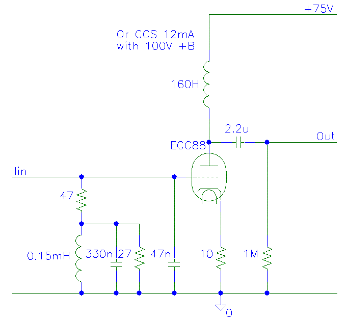

Observed another thing , when DAC output is loaded with 47R I/V resistor voltage is around -95mV. Inserting tube to output stage (Ecc88) cause raise in output voltage to -0.6V ?????
Hi Slav,
Did you connect according to Thorsten circuit? Its because from your post #11, you dont seems to do it correctly.
For Thorsten's Adagio DAC, I saw at least 1 error. On the TM-3 connection, very wrong. Does anyone have the correct and clearer circuitry of Thorsten's Adagio especially on the output stage to share?
Yes, you are right. Jus connect as per the circuit, dont care about the ground till you are able to get a sound.
Jus connect directly either 1541A pin25 or pin 6 to the ECC88 output stage shown.
All connections exactly as on schematic , but no sound .
I have measured voltage on I/V resistor (47R) without tube in socket - 95mV , tube in socket and I have over 600mV?
