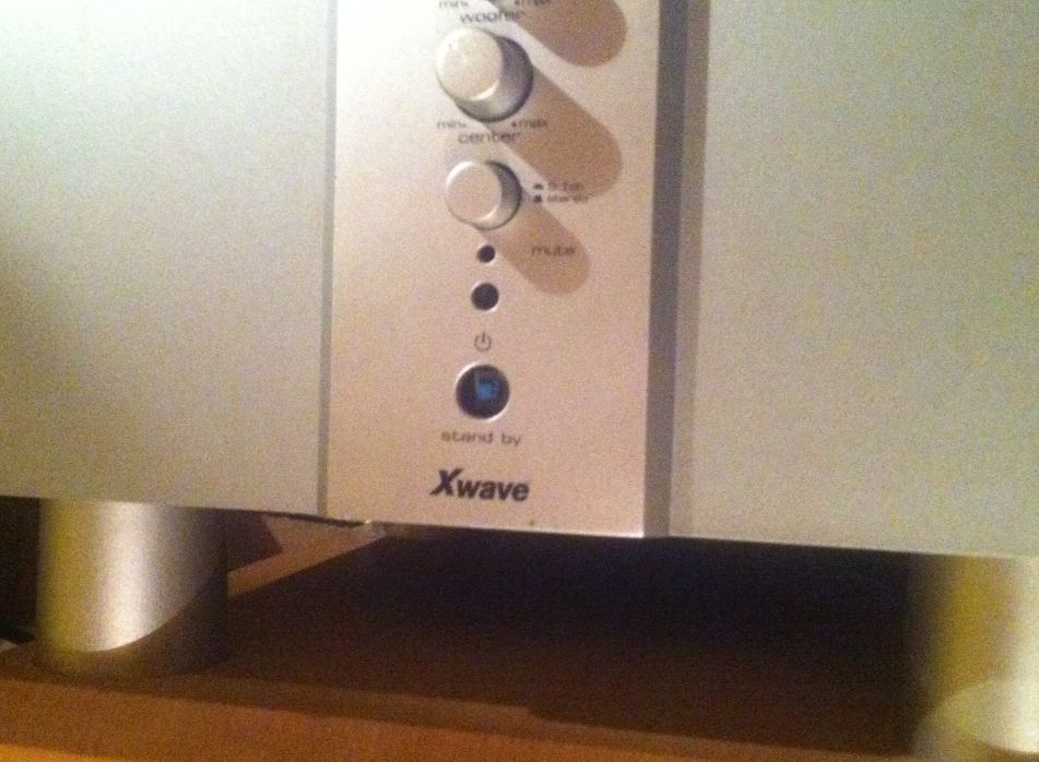

I have this 5.1 speakers Xwave Theatro. Old, but very good speakers.
The thing is that in order for speakers to work I need to keep stand by button pressed. It used to turn on and off with touching the button. Now I need jammed toothpick 🙂
Only IC-s are PT2259A which is remote control/volume, I guess from looking in datasheet. Second one is basic logic 4013. I changed that one but it still does not work.
With button pressed, there is sound but power led does not glow.

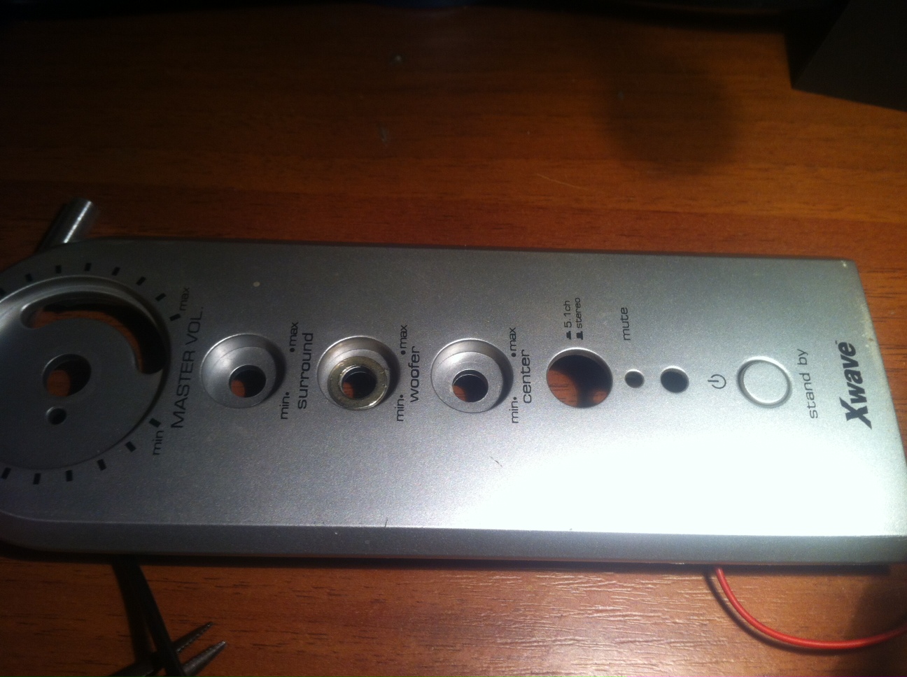

Where do you see a 4013 flip-flop? I see no 14-pin DIPs anywhere.
What about the guy right in the middle of the board?
Though looking at it again, I'd rather be expecting a quad opamp in that spot, would make more sense with the tone controls and all...
Oh look, the board says JUSTER. These guys used to make a whole bunch of PC speakers back in the early 2000s (and would have been the actual OEM here), I wonder what happened to them?
I don't think it is "soft power". I think that 18-terminal switch IS both power and mute.
When you work it, a little U-wire in a V groove right behind the button goes one way and the other to latch the button in. Same as the click in a retractable pen. The gizmo goes bad. See if you can set it back in the groove. But sometimes a toothpick IS the solution. (You may be able to jam the switch inside, so the toothpick isn't sticking out where it gets lost.)
Thanks guys for all the trouble 🙂
After many hours with testing and soldering, the result is not a toothpick, but close to it.
I have found one button switch same size as the original push buton. Now it works!
