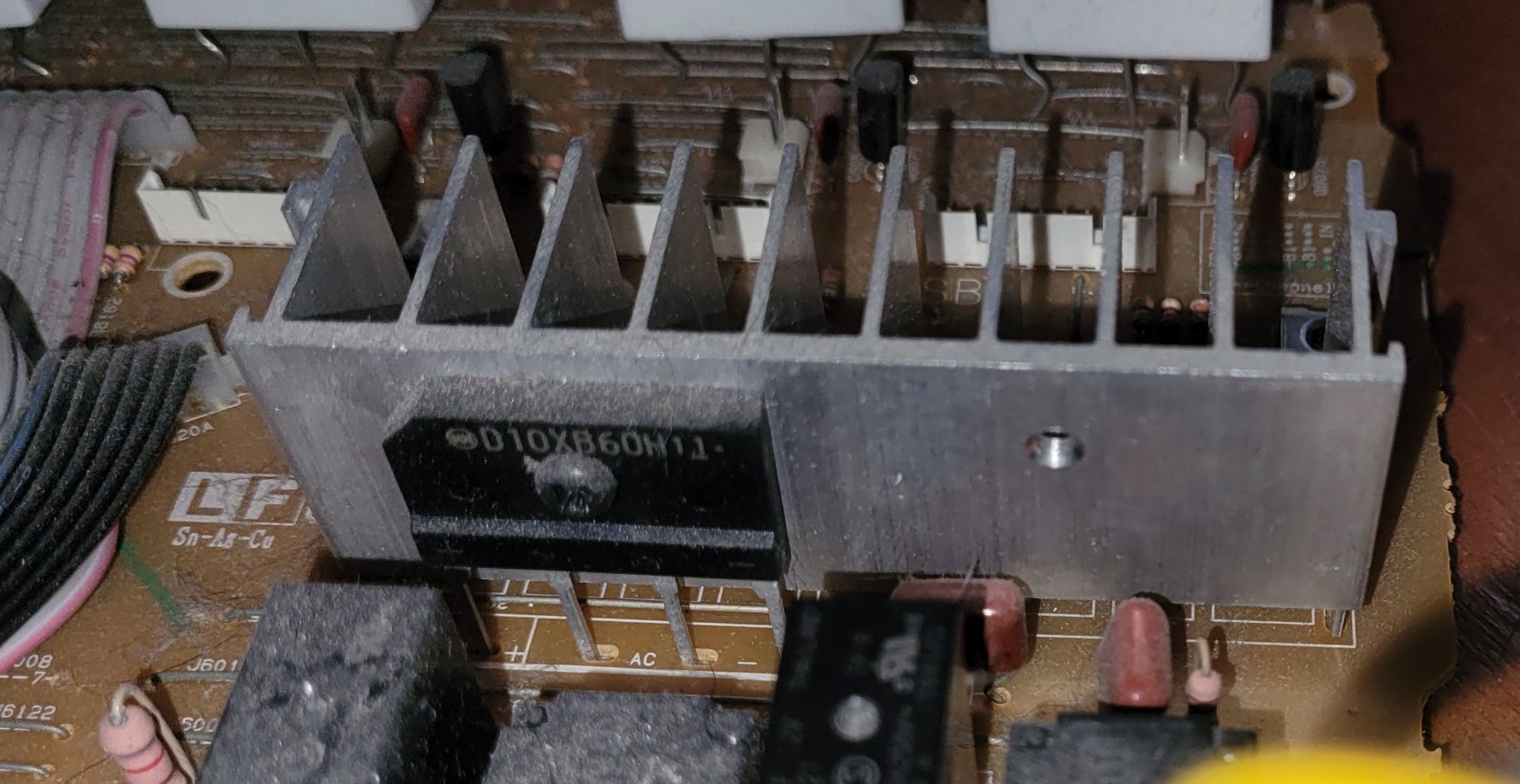

They also have good looking heatsinks:
This is the most typical kind found in the 300-600w models. Some are larger.
These weigh about 900g and measure:
289mm x 94mm x 50mm.
I estimate their dissipation at something like 0.5C/W
I imagine that 2 could be stacked on top of one another with some aluminium plate used as a heat spreader to make a larger heatsink appropriate for higher power designs. Something I intend to try in the future.
The largest heatsink I have found so far was from a TX-SR602 which was 130mm tall compared to the usual 94mm.

  • good heatsinks for rectifiers/regulators
