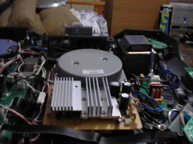

Can anyone help me... Bought a pair of Numark TTX1 turntables 2 years ago.. Was using them as per usual, stopped one of them, and when I went to start it again nothing happened. This was a surprise in itself as I take good care of them and I'm 3 years into a degree in electronic engineering so I know things like this shouldn't just happen. Then a week later, was using the other turntable when the same thing happened. Emailed Numark about it a couple of times and pretty much ignored what I told them each time.
Now I bought them over-seas so it's a pain to send them back for repair... I opened one of them up to a have a look and saw no sign of burnt our parts, or any damage. Now as far as I know it is the motor that is at fault as I'm pretty sure the buttons for starting and stopping the platter work fine. So does anyone know what caused this and if there's anything I could do to fix this myself? Any comments muchly appreciated!

seems a shame no noe's tried to help you with this - you've done all the usual checks for burned out components, fuses etc(!); you should be able to back work it from the motors themselves. Work out what supplies they should be recieving & test that it's happening. Have you disconnected the motors & got them working on a seperate circuit?
well the motor itself is attached to a circuit board with other components on it and it is hard to see how I could isolate it, I don't have any experience with dismantling circuits or the like so not really sure how I should go about it. I'm not even sure what is attaching it to the circuit board. I've since found out that this has been a problem for some other users of this model thus being a design fault. Unfortuately Numark won't even accept responsibility! Apparently the heat sink isn't adequate for the motor so after a certain amount of use they just break themselves. Is it even worth repairing? Or even easily repairable?
When you use the words heatsink and motor in the same sentance, that usually emplies some sort of speed control device. It's either on the board or in the motor - can you get a couple of shots front & back?

here's a few pics of the motor, I spent quite a while going over every detail of the turntable today and it was very frustrating when I couldn't find anything obviously wrong. There's another small heatsink to the left of the motor in the first pic. When I unscrewed that there was a bronze colour around some solder on a circuit board attached to it, looked like it heated up 2 much but it's hard to say if any damage was done. Will try get a pic of that up the next day. Thanks a million for your time Jezz!

Picture 4s shows the culprit presumably; can you make out the number of the chip through the heat - transfer compund?

hey Jezz, wont have a chance to check out that serial number for a few days... bein doin more research as to my problem im having. It's hard to find what the specific problem is, I only found one person that said it was a heatsink problem and thats all I know. Found a few reports of the motors just overheating, so Im not sure if the speed control IC would be damaged as a result of this or the motor itself? Apparently they brought out a newer version of this turntable with air vents below the platter to solve this problem. I have to say they are a ridiculous company when it comes to company care. I've even been trying to order replacement motor units directly from their parts department and they're taking forever to respond. Very annoying. Any opinions?? p.s. Never trust a Numark product!!

I own two TTX1 turntables also. One crapped out on me awhile back. Replaced the motor drive chip (TA7259P). This did not fix the problem. I have tried to contact NUMARK relentlessly with NO Success. I will NEVER BUY or support numark or there product ever again.

I believe there is some other electronic component causing the motors to fail or else the motor itself is to blame. Possibly the platter sensor. I bought my ttx1's back in 2003 when they first came out so our components are slightly different. However your generation turntable should of had all the bugs worked out. At least that is what I understand from reading and research. I am just so disappointed in NUMARKS lack of interest and coorperation when it comes to servicing there products. The almighty dollar rules again.
