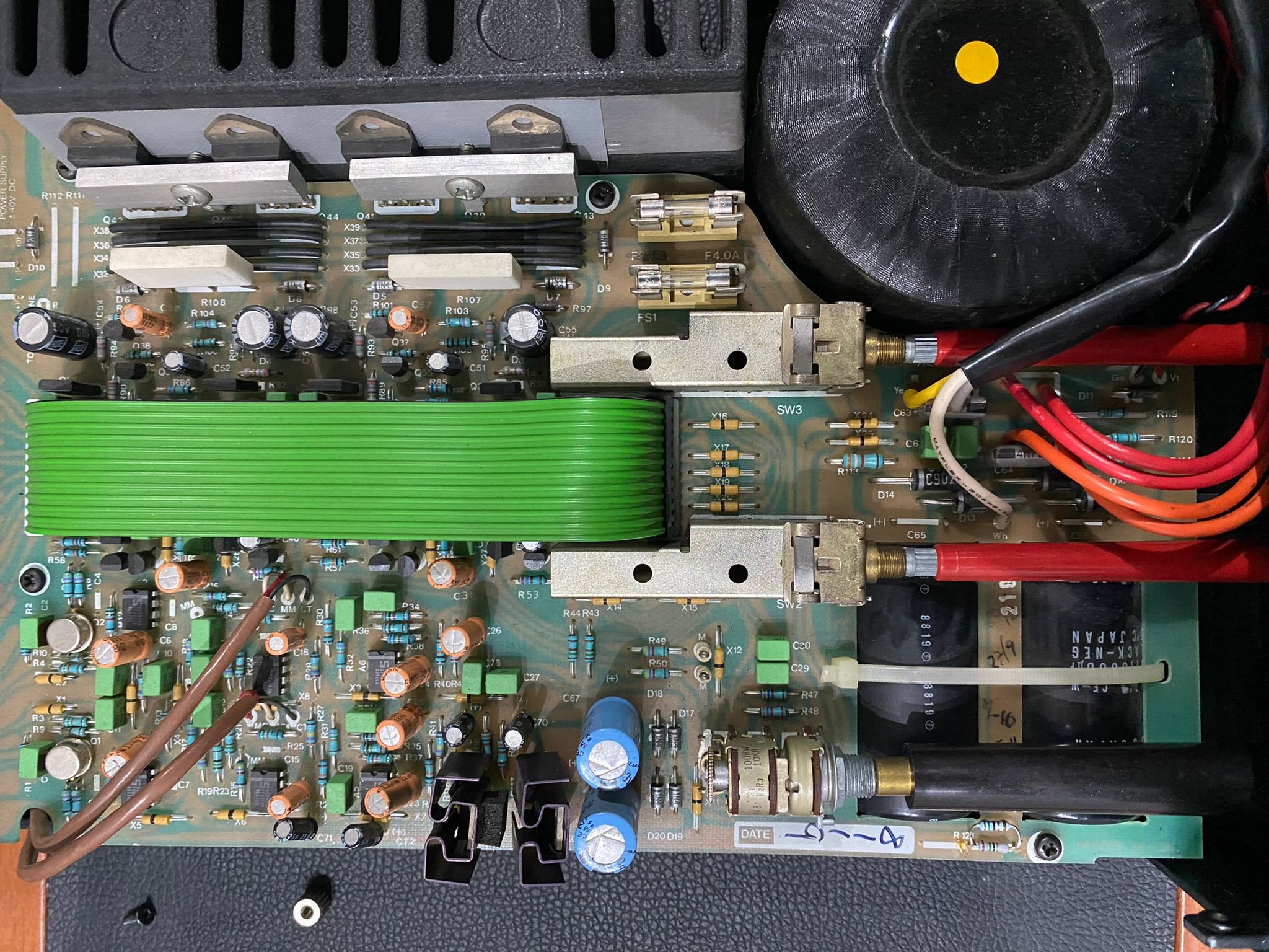

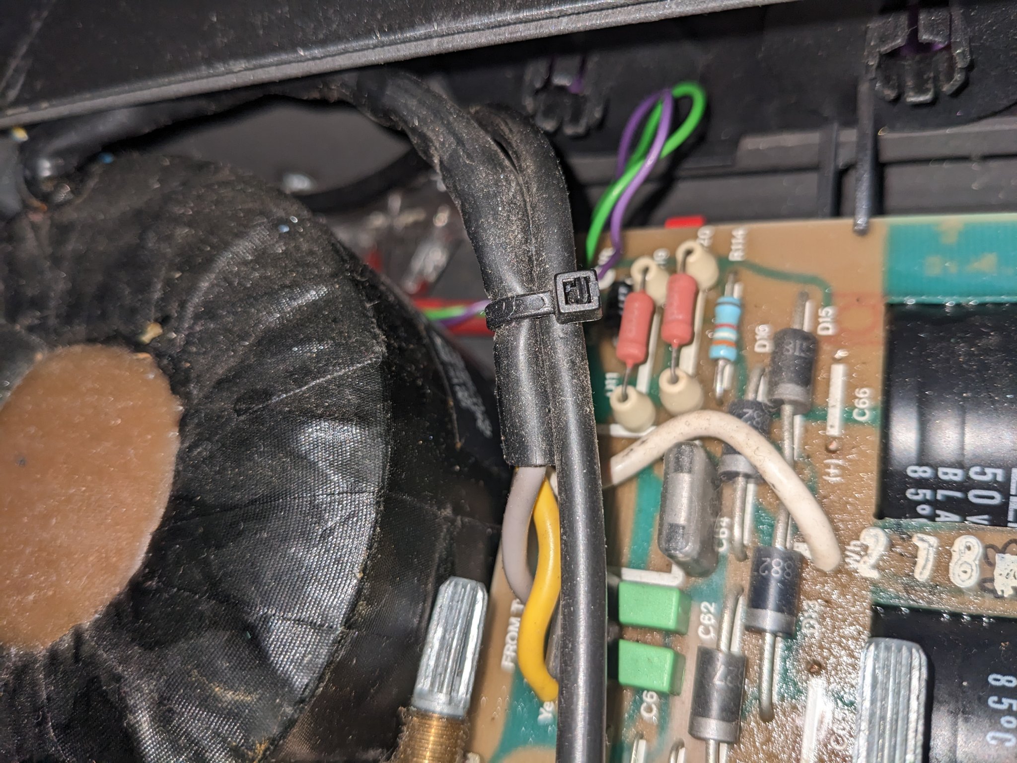

Hello Sorry for the automatic translation .....But I'm Italian from Venice....I recently bought a pair of Mission Cyrus two + PSX I noticed that in the cyrus two inside the R 121 section instead there are 2 resistors of only one as I usually see on sites where this amp is mentioned and I saw that the F4 fuse pair was not removed to pair the PSX, is my question normal? From the videos he sent me during the purchase we can see that the old owner had both 2 frames (Cyrus + PSX) with the power leds on, so he used the internal power supply of the Cyrus, I still ask if this is normal or damaged if not remove the F4 fuses inside the Cyrus using it in pairs Cyrus + PSX thanks I hope someone can help me Merry Christmas everyone
